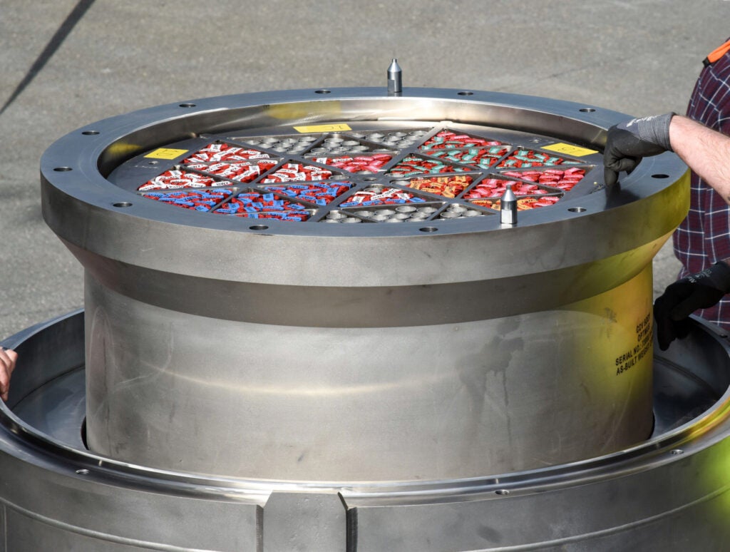

BWXT prepares to ship TRISO fuel compacts manufactured for Antares Nuclear Inc.’s Mark-0 microreactor, which achieved zero-power criticality under DOE’s Reactor Pilot Program on June 4, 2026. Courtesy: BWXT

TRISO fuel compacts produced at BWXT’s Specialty Fuels Fabrication facility in Lynchburg, Virginia, for Antares Nuclear’s Mark-0 criticality demonstration on June 4, 2026. Courtesy: BWXT

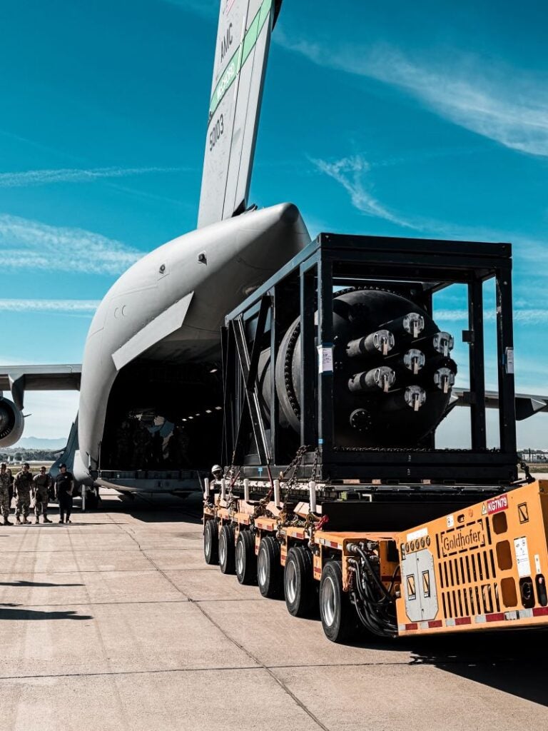

Airmen assigned to the 452nd Logistics Readiness Squadron Aerial Port Flight support loading operations of the Valar Atomics Ward 250 reactor onto a C-17 Globemaster III at March Air Reserve Base, Calif., Feb. 15, 2026. The mission, called "Operation Windlord," marked the first military airlift of a microreactor and transported the Ward 250 to Hill Air Force Base, Utah, en route to the San Rafael Energy Lab test site. Courtesy: Valar Atomics
The 452nd Logistics Readiness Squadron Aerial Port Flight support loading operations of the Valar Atomics Ward 250 reactor onto a C-17 Globemaster III at March Air Reserve Base, Calif., Feb. 15, 2026. The mission, called “Operation Windlord,” marked the first military airlift of a microreactor and transported the Ward 250 to Hill Air Force Base, Utah, en route to the San Rafael Energy Lab test site. Courtesy: Valar Atomics

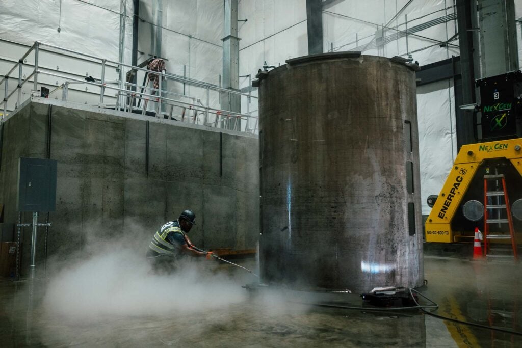

INSERT ART. Inside Aalo's Critical Test Reactor building at INL as the core barrel is cleaned. Courtesy: Aalo Atomics
Inside Aalo’s Critical Test Reactor building at INL as the core barrel is cleaned. Courtesy: Aalo Atomics
