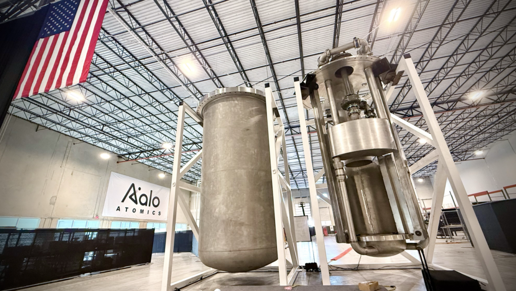

On April 8, 2025, Austin-based startup Aalo Atomics unveiled the first non-nuclear prototype of its Aalo-1 reactor alongside the opening of its new 40,000-square-foot manufacturing facility in Austin, Texas. The prototype demonstrates the company’s “XMR” (extra modular reactor) design—purpose-built to supply fast, reliable, and carbon-free power for AI and data centers. Company officials said the prototype marks a critical milestone toward validating manufacturability, modularity, and integration of the Aalo Pod, a 50-MWe plant that scales to gigawatts, ahead of first nuclear deployment targeted for 2026. Courtesy: Aalo Atomics
 Austin-based startup Aalo Atomics in April 2025 unveiled the first non-nuclear prototype of its Aalo-1 reactor alongside the opening of its new 40,000-square-foot manufacturing facility in Austin, Texas. The prototype demonstrates the company’s “XMR” (extra modular reactor) design, which is purpose-built to supply fast, reliable, and carbon-free power for AI and data centers. Company officials said the prototype marks a critical milestone toward validating manufacturability, modularity, and integration of the Aalo Pod, a 50-MWe plant that scales to gigawatts, ahead of first nuclear deployment targeted for 2026. Courtesy: Aalo Atomics

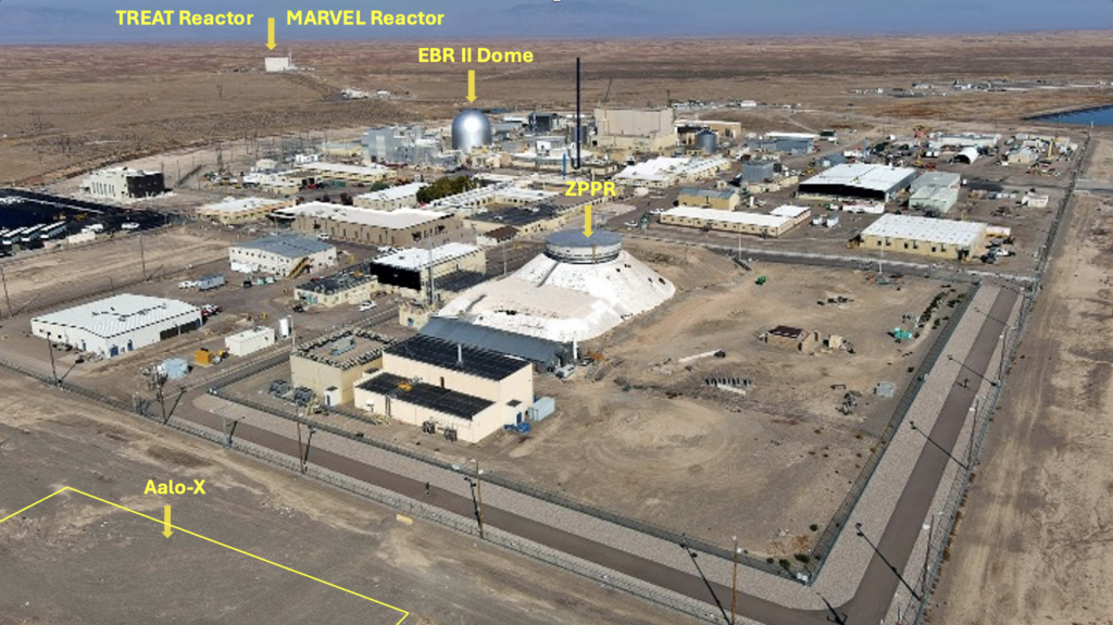

Planned site for Aalo Atomics’ Aalo-X microreactor at Idaho National Laboratory (INL). Under DOE’s new Nuclear Reactor Pilot Program, the Austin-based firm will sponsor, design, and co-operate the project with INL as design authority and co-operator, while DOE serves as authorization body. The Aalo-X is slated to demonstrate cold criticality in July 2026. Aalo is also planning an experimental data center next to the reactor, marking the first time a nuclear plant and data center are built together—a potential model for gigawatt-scale deployments in the future. Courtesy: Aalo Atomics
