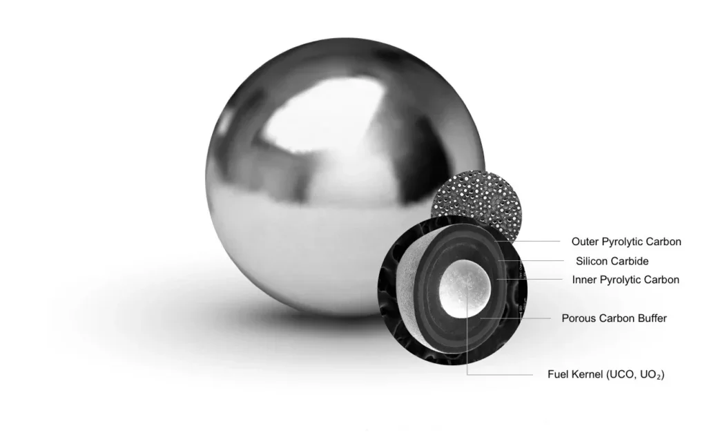

TRISO fuel particles consist of uranium fuel kernels coated with four protective layers: porous carbon buffer, inner pyrolytic carbon, silicon carbide, and outer pyrolytic carbon. The multilayered design retains fission products at elevated temperatures. Thousands of coated particles are embedded in graphite to form spherical pebbles approximately 60 mm in diameter for use in high-temperature gas-cooled reactors like X-energy's Xe-100. Courtesy: X-energy
TRISO fuel particles consist of uranium fuel kernels coated with four protective layers: porous carbon buffer, inner pyrolytic carbon, silicon carbide, and outer pyrolytic carbon. The multilayered design retains fission products at elevated temperatures. Thousands of coated particles are embedded in graphite to form spherical pebbles approximately 60 mm in diameter for use in high-temperature gas-cooled reactors like X-energy’s Xe-100. Courtesy: X-energy

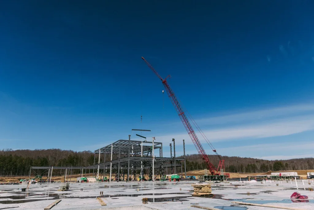

Structural steel is erected at TRISO-X’s TX-1 fuel fabrication facility at the Oak Ridge Horizon Center Site in Oak Ridge, Tennessee. Vertical construction began Nov. 17, 2025. On Feb. 13, 2026, the U.S. Nuclear Regulatory Commission issued the first-ever U.S. approval of a Category II fuel fabrication facility for the project. Courtesy: X-energy

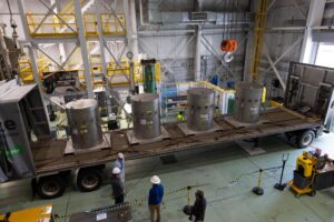

Project Pele, the Department of War’s (DOW’s) first-of-its-kind transportable nuclear microreactor prototype, received its tri-structural isotropic (TRISO) particle fuel in December 2025 at Idaho National Laboratory (INL), where formal system testing is slated to begin as early as 2027. The fuel—manufactured by BWXT Technologies (BWXT) and shipped from its Lynchburg, Virginia, facility—represents the first TRISO microreactor fuel delivered at its final destination and builds on more than two decades of TRISO fuel development and qualification work. For more, see POWER‘s in-depth story: A First for Military Nuclear Power: TRISO Fuel Arrives at Project Pele
INL staff prepare to receive tri-structural isotropic (TRISO) particle fuel manufactured by BWX Technologies Inc. in December 2025 for Project Pele’s planned testing. Source: INL
