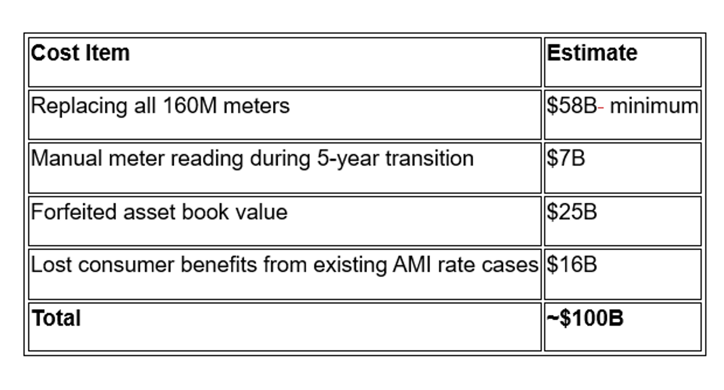

The Cost to Utilities and Ratepayers
According to analysis from critical utility infrastructure providers, the costs to utilities and ratepayers would be at least $100 billion, further exacerbating the affordability issues they already face. Utility bills are a particular driver of affordability issues, since electricity rates have increased 35%-45% in the last five years, according to the Energy Information Administration.
The NextNav proposal seeks to shrink available spectrum for these devices by 60%. Courtesy: Landis+Gyr
The Edison Electric Institute (EEI) estimates that the proposal will result in potential costs for each utility of up to $4 billion spread over a 10–15-year replacement cycle. These costs would be passed to ratepayers who have already paid for useful, regulator-approved infrastructure.
