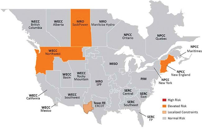

For the first time in several summers, the North American grid is heading into the cooling season without a single region flagged as high-risk. The North American Electric Reliability Corporation’s (NERC’s) 2026 Summer Reliability Assessment, released in May, found every assessment area carries adequate anticipated resources for normal peak conditions, and it identified only a handful of areas—New England, SaskPower, the Northwest, and pockets of Far West Texas—facing elevated risk under more extreme scenarios. The bulk power system added slightly more than 58 GW of new resources year on year, a build-out large enough to outpace demand growth and lift reserves across much of the continent (Figure 1).
1. The North American Electric Reliability Corporation’s (NERC’s) 2026 Summer Reliability Assessment expects sufficient operating reserves across most of its jurisdiction, with elevated risk only in parts of New England, Texas, Saskatchewan, and the Northwestern U.S. Courtesy: NERC
That is a notably calmer reading than the one NERC delivered a year earlier, and the reasons run deeper than a single mild forecast. Aggregated peak demand still climbed by more than 11 GW from the prior summer’s projections—growth that actually exceeds the 10-GW rise that preceded summer 2025—but several assessment areas have revised their load forecasts downward to account for large loads arriving more slowly than anticipated. The grid, in other words, caught a break on both ends: more supply showed up, and some of the demand that planners feared did not.
