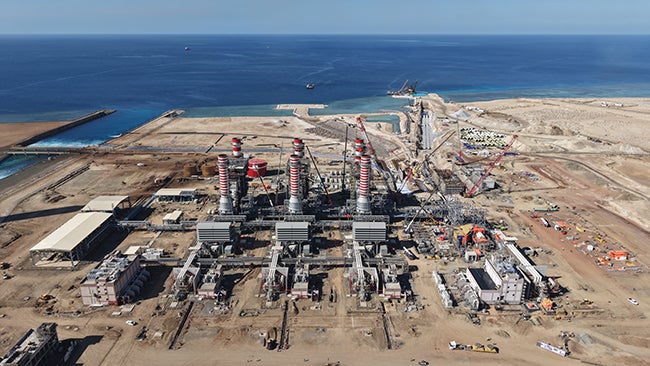

1. The first of three gas turbines fired on July 19, 2025, at the Rabigh Reinforcement Combined Cycle Power Plant in Saudi Arabia. Courtesy: Siemens Energy
