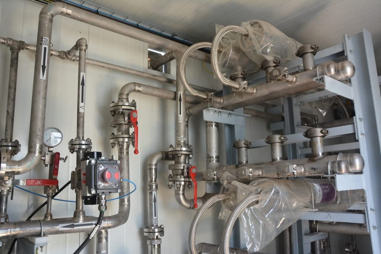

1. Officials inspect the modular biomethane production unit at the Martí plant in Matanzas province, developed with European Union funding through the Global Climate Change Alliance Plus (GCCA+) initiative. Courtesy: Amaury Pérez Sánchez

“In the case of this plant, the gas it receives comes through pipelines from biodigesters located 9 kilometers (km) and 5 km away,” Ramón Castellarnau Font, a specialist at Gea Energia Crio S.L. (GEcrio), a company providing solutions, equipment, and services for the cryogenic industry, explained to the local newspaper Girón.
“We have the gasometers, which is where all that ‘dirty’ biogas accumulates. The plant removes the hydrogen sulfide and CO2 [carbon dioxide]. We compress this clean gas to high pressure, up to 200 bar, and store it in cylinders located in the vehicle refueling area. In addition to the five buses, there are also two vans that run on it and have a range of 300 to 400 km,” Castellarnau said.
The plant (Figure 2) has a production capacity of 150 cubic meters of raw biogas per hour, yielding about 40 kilograms (kg) of purified biomethane. One of the experts explained, “It’s essential that we have enough gas at the inlet to produce, because the digesters are feeding the biogas; it’s a living substance that is affected by temperature, the quality of what the pigs have eaten—it’s affected by everything. So, we have to keep adjusting it. That’s why, to avoid supply problems, we have 98 cylinders here, representing 5,000 kg of gas. Each bus has a maximum fuel capacity of 90 to 100 kg, so there’s plenty of reserve to power all the buses. We’re currently in the commissioning phase, identifying any potential issues with the plant, adjusting parameters and sensors, and starting production.”

2. Purification equipment at Cuba’s first biomethane plant in Martí, Matanzas, where raw biogas from nearby pig farms is cleaned for use as vehicle fuel and electricity generation. Courtesy: Amaury Pérez Sánchez
