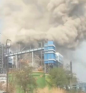

A catastrophic boiler explosion at Vedanta Limited’s Chhattisgarh Thermal Power Plant (VLCTPP) in east‑central India has left scores of workers dead and injured, prompting questions over boiler safety enforcement and operator oversight at privately owned coal plants in the country.
The explosion, which occurred on April 14, has triggered parallel criminal, technical, and administrative investigations into alleged safety lapses and negligent operation at the coal‑fired station. While casualty figures vary across official and media accounts and may be revised as critically injured workers succumb to their injuries, The Economic Times reported on April 19 that the death toll had risen to 24. Four workers died at the scene, and others succumbed to burn injuries over the following days. At least 36 workers were suffering “grievous burn injuries,” and three were still in critical condition, the newspaper said.

According to police and company statements reported by  NDTV and other Indian outlets, the April 14 blast occurred in Unit 1 when a tube carrying high‑pressure steam from Boiler 1 to the turbine ruptured, releasing superheated steam and causing extensive burn injuries among workers in the area.
