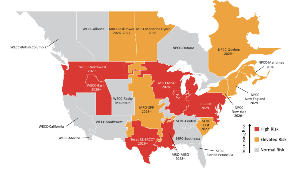

Five Regions to Face ‘High’ Risk by 2030
As Mark Olson, NERC’s manager of Reliability Assessments, explained, another key finding of the report is that “resource adequacy concerns are mounting”—meaning, essentially, that despite surging demand expectations, projected supply growth is not keeping pace.
According to NERC’s capacity and energy risk assessment—which identifies potential future electricity supply shortfalls under normal and extreme weather conditions based on bulk power system (BPS) planning forecasts—13 of 23 assessment areas will face resource adequacy challenges over the next five years. By 2030, at least five regions could face “high risk”: the Midcontinent Independent System Operator (MISO), PJM Interconnection (PJM), the Electric Reliability Council of Texas (ERCOT), and the Western Electricity Coordinating Council’s (WECC’s) Basin and Northwest subregions.
“There’s normal, elevated, and high risk,” explained Olson. “The normal risk areas shown in gray are all meeting their resource adequacy targets, and the all-hours probabilistic analysis generally indicates little or no unserved energy or load loss—even under a variety of conditions. More extreme conditions are baked into that analysis as well.”
“The areas in orange are elevated risk,” Olson continued. “These areas are meeting their adequacy targets and generally meet the one-day-in-10-year load loss criteria, but in our probabilistic and all-hours studies, some unserved energy and load loss begin to emerge. That generally indicates that more extreme conditions—like extreme cold or above-normal temperatures—are more likely to result in load loss given the current resource and load projections.”
“For the areas marked as high risk,” he added, “these are either falling short of a reserve margin target established by a regulatory authority or exceeding the criteria for unserved energy and load loss used in this report—criteria that generally align with a one-day-in-10-year threshold for load loss sometime in the next five years.”
“What we’re seeing this year,” Olson said, “is that many regions move into elevated or high risk later in the decade as demand rises and planned generation fails to keep pace.”
Thirteen of 23 North American assessment areas face elevated or high resource adequacy risks over the next five years, according to NERC's 2025 Long-Term Reliability Assessment released Jan. 29, 2026. High-risk regions (red) include MISO, PJM, Texas RE-ERCOT, WECC-Northwest, WECC-Basin, and SERC-Central, where planned resources would result in energy shortfalls exceeding adequacy targets. Elevated-risk areas (orange) meet baseline criteria but face potential shortfalls under extreme weather conditions. Years shown indicate when each region's highest risk level first occurs during 2026–2030. Source: NERC
Thirteen of 23 North American assessment areas face elevated or high resource adequacy risks over the next five years, according to NERC’s 2025 Long-Term Reliability Assessment released Jan. 29, 2026. High-risk regions (red) include MISO, PJM, Texas RE-ERCOT, WECC-Northwest, WECC-Basin, and SERC-Central, where planned resources would result in energy shortfalls exceeding adequacy targets. Elevated-risk areas (orange) meet baseline criteria but face potential shortfalls under extreme weather conditions. Years shown indicate when each region’s highest risk level first occurs during 2026–2030. Source: NERC LTRA 2025
The regions facing the highest risk are contending with steep load growth that consistently outpaces planned resource additions, particularly as thermal retirements mount and solar-heavy additions introduce variability, the report shows. In ERCOT and PJM, notably, demand from data centers could erode resource margins below targets later in the decade despite efforts to expedite new capacity. And in parts of the Western Interconnection, growing reliance on variable renewables could contribute to year-round adequacy concerns. Elevated-risk areas—including portions of MRO, NPCC, and SERC—could grapple with other specific vulnerabilities such as low-hydro conditions, fuel constraints, peaker retirements, and seasonal maintenance gaps that heighten the risk of energy shortfalls, particularly under extreme weather, the report says.
