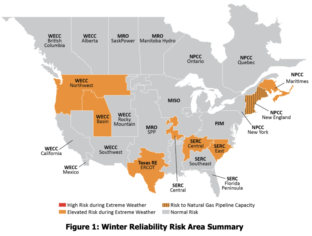

NERC’s 2025–2026 Winter Reliability Assessment highlights regions at elevated risk of electricity shortfalls during extreme winter conditions, including the Maritimes, New England, parts of the Southeast, Texas, and portions of the West. The striped Maritimes area indicates specific risk to natural gas pipeline capacity. Source: NERC.

NERC notably flagged seven areas facing risks of electricity supply shortfalls during extreme conditions this winter. In the Northeast, NPCC-Maritimes is the only area that does not meet its reference margin level, with an anticipated reserve margin of 16.9%—270 MW below its 20% target—and operators there are “likely to require emergency operating mitigations and/or energy emergency alerts during above-normal demand or low-resource output conditions.”
New England, while showing limited exposure to shortfalls in ISO-NE’s scenario analysis, faces standing concerns about energy adequacy during extended cold snaps, where “constrained natural gas pipelines contribute to rapid depletion of stored fuel supplies.” In parts of the Southeast, SERC-East has shifted from a summer-peaking area to potentially peaking during both summer and winter—driven by the continued addition of solar PV generation that shaves off summer peak demand and electrification of heating that drives up winter peak demand. The winter peak demand forecast has increased by 700 MW (1.6%) since last winter, while firm capacity has declined, resulting in lower reserves.
In Texas, strong load growth from new data centers and other large industrial end users is driving higher winter electricity demand forecasts and contributing to the continued risk of supply shortfalls, according to the assessment. ERCOT faces reserve-shortage risks during peak and high-net-load hours, particularly under extreme cold conditions. The report also noted that data centers are “altering the daily load shape due to their round-the-clock operating pattern, lengthening peak demand periods.” While additional battery storage and demand-response resources since last winter have helped mitigate shortfall risks, NERC cautioned that “with the continued flattening of the load curve, maintaining sufficient battery state of charge will become increasingly challenging for extended periods of high loads, such as a severe multi-day storm like Winter Storm Uri.”
In the West, WECC-Basin—which includes Utah, southern Idaho, and a portion of western Wyoming—has sufficient capacity for expected peak conditions, but Balancing Authorities are “likely to require external assistance during extreme winter weather that causes thermal plant outages, adverse wind turbine conditions, and natural gas fuel supply issues.” Under an extreme combination of generator derates and outages, the region could be short 1.6 GW before imports. Similarly, WECC-Northwest faces a 9.3% increase in winter peak demand compared to last year. While over 3 GW of new resources—primarily battery storage, solar PV, and wind—have been in development for the area this year, NERC warned that “delays that threaten timely completion of these resource additions will make the area more reliant on imports to meet peak demand.” In both regions, external assistance “may not be available during region-wide extreme winter conditions.”
