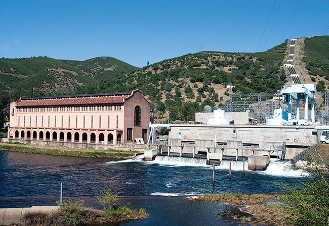

For an asset like Moccasin, that tradeoff is not a compromise but the entire design philosophy. “Reliability and lower downtime have a bigger impact than maximum efficiency in this kind of situation,” Thibault said. The water conveyed through the units originates in Yosemite National Park and is clean enough that it requires no filtration before delivery. The generators function, in effect, as a financially useful way to dissipate energy that would otherwise have to be shed some other way as the water drops from the mountains to the Bay (Figure 1).
1. The Moccasin Powerhouse in the Sierra Nevada foothills, where water descending from Yosemite is conveyed to the San Francisco Bay Area. The penstocks visible on the hillside at right feed turbines whose primary job is to break the pressure head of that descent. Courtesy: GE Vernova

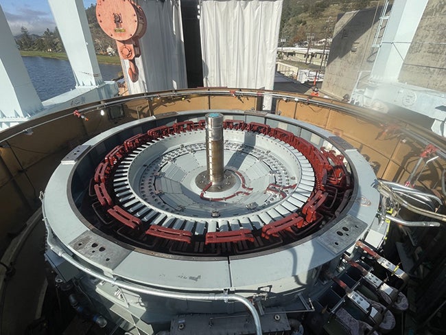

Hitting that window required a swap-ready strategy. There was no time to refurbish the existing structural components in place, so the team had a new stator frame and rotor rim built and waiting to drop in (Figure 2). “There wouldn’t have been enough time if SFPUC had wanted to keep the old frame,” Thibault said. The approach turned the outage into an exchange rather than a rebuild-in-situ, compressing months of potential work into the available months.
2. The rotor of one of Moccasin’s two new 55-MW units, set into the stator during the rewind. The pre-built stator frame and rotor rim allowed the team to swap components rather than rebuild in place, a key to fitting the work into the December-to-April outage window. Courtesy: GE Vernova
