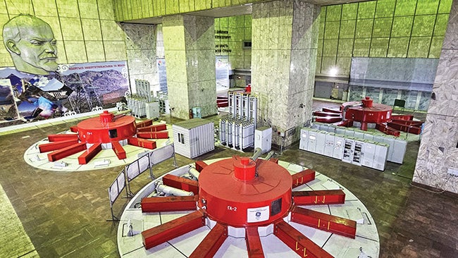

The headline number is a per-unit increase from 300 MW to 360 MW across all four machines. According to Sergey Sakhovskiy, project director for GE Vernova, the gain came not from any single component swap but from a combined modernization of the turbine and generator systems. The project team installed new Francis runners and hydraulic passage components, completed generator stator and rotor work, upgraded governors and control systems, and modernized excitation and protection systems, all backed by refurbishment of embedded and auxiliary equipment. The original 300-MW units were rebuilt to 360 MW with a corresponding improvement in efficiency, and the performance guarantees, Sakhovskiy said, point to higher guaranteed turbine output and strong generator efficiency at rated head (Figure 1).
1. GE Vernova rebuilt all four Francis units from 300 MW to 360 MW apiece, lifting Toktogul’s total capacity to 1,440 MW. Courtesy: GE Vernovas
