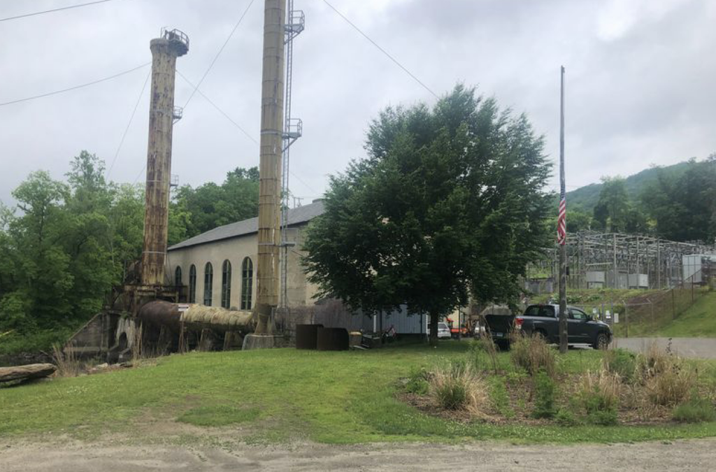

Construction of the Bulls Bridge Hydroelectric Plant in New Milford, Connecticut, began in 1902. When the plant entered operation the following year, it became the first commercially viable hydroelectric power plant on the Housatonic River.
1. Bulls Bridge Hydroelectric, which first came online in 1903, stands as a testament to early 20th-century hydroelectric engineering. Courtesy: National Breaker Services
Now, almost 125 years later, Bulls Bridge continues to function as a run-of-the-river hydroelectric facility (Figure 1) that utilizes its original turbines, penstocks, and canal systems. In doing so, Bulls Bridge delivers about 8.2 to 8.4 MW of generation at full capacity, with a discharge capability of 1,200 cubic feet per second. The plant annually generates about 30.8 GWh of power, ranking it third in hydroelectric output, and 38th overall among Connecticut power plants of all types.

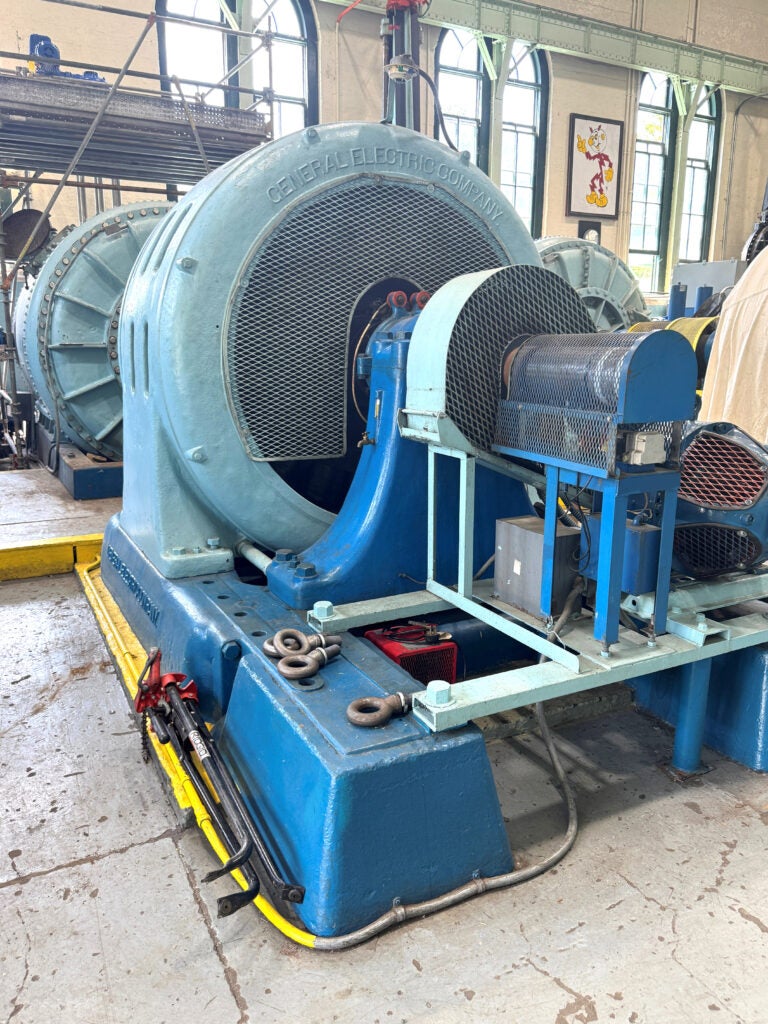

The plant today utilizes six horizontal double-runner Model F-1 Francis turbine units that were originally installed in 1903. Each unit is coupled to General Electric generators (one of those units has replaced the original equipment). The turbine-generator units are fed by water routed through a power canal that is just more than two miles long, with water carried through 420-foot-long penstocks that take the water under about 105 feet of hydraulic head down to the powerhouse.
2. The Bulls Bridge plant utilizes six original Francis turbine units installed in 1903, each coupled to General Electric generators. Courtesy: National Breaker Services

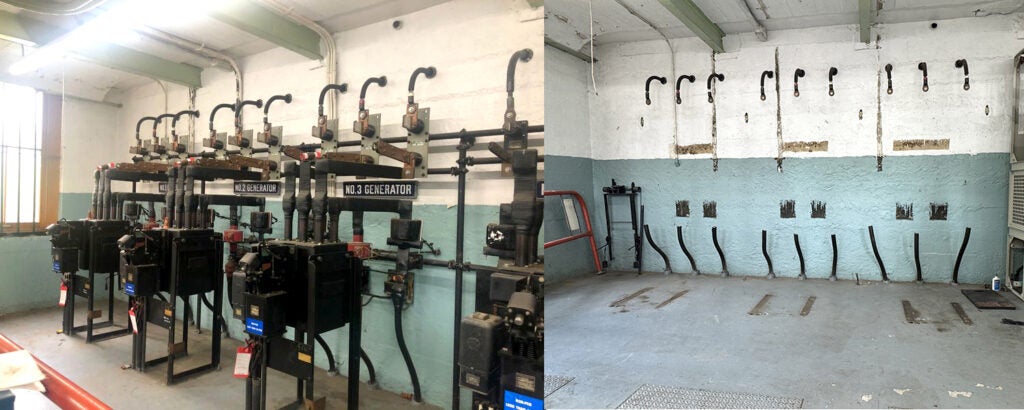

3. For the retrofit, National Breaker Services was called in to replace all six breakers with draw-out style vacuum circuit breakers. Courtesy: National Breaker Services
Because of these factors, the 1903-era breakers (Figure 3) were replaced with updated designs that utilize advanced vacuum interrupter technology. A vacuum circuit breaker interrupts current by separating contacts in a sealed vacuum chamber, where the arc is quickly extinguished because there are no gases or materials to sustain it.

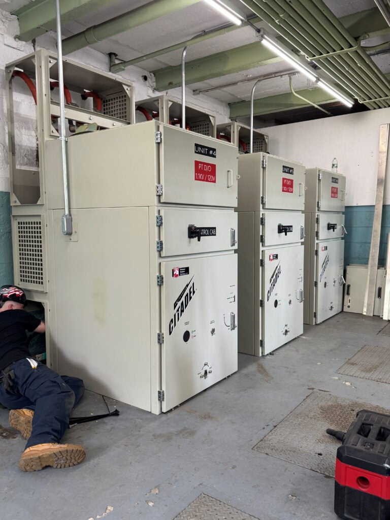

4. National Breaker Services removed the old breakers at the hydroelectric facility, and installed six new custom enclosures with draw-out style breakers. Courtesy: National Breaker Services

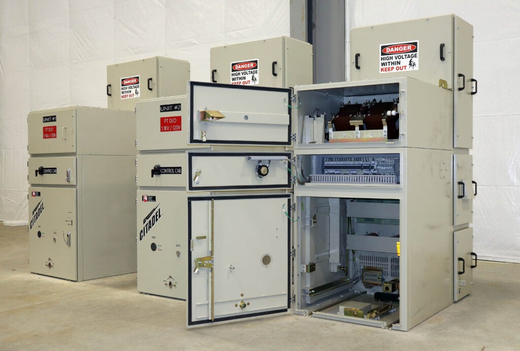

5. The custom Citadel enclosures incorporate draw-out potential transformer assemblies, a modern feature that did not exist on the original 1903 breakers. Courtesy: National Breaker Services
Over time, this platform evolved into a draw-out breaker design featuring remote racking options and roll-in replacement capabilities (Figure 5), meeting high performance levels including ratings up to 38 kV and current capacities of 5,000 A at 63 kA. NBS also offers indoor and outdoor switchgear, including dog houses, free standing units, walk-in common aisle substations, generator accessory cubicles, and modular engineering, procurement, and construction (EPC) line ups.
In this case, the Bulls Bridge project involved retrofitting the 1903 breakers with modern circuit breaker systems. Given the date of the original installation, the circuit breakers were not housed in the type of protective metal enclosure that became standard practice roughly 50 years later and remain in use today. Instead, they were open-air, a design that was common at the time but could pose potential safety risks for plant personnel.
After careful onsite measurements were gathered to ensure the new equipment could be engineered and designed to fit the very tight footprint, NBS removed the old breakers and installed six new custom enclosures with draw-out style breakers, in a process that took about two weeks. A draw-out breaker is designed to be inserted into and withdrawn from a switchgear cubicle or breaker compartment without having to disconnect the wiring or bus connections manually. This design provides flexibility, ease of maintenance, and improved safety compared to fixed-mounted breakers. The custom Citadel enclosures also incorporate draw-out potential transformer assemblies, a modern feature that did not exist on the original 1903 breakers.
