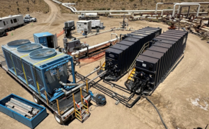

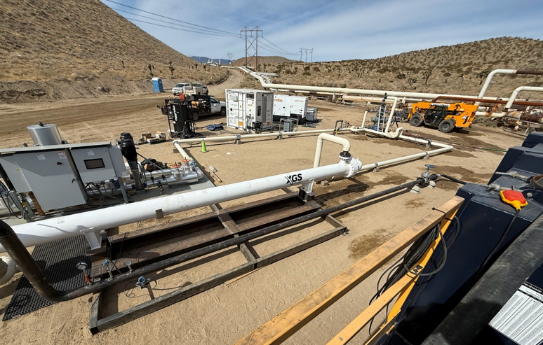

XGS has expanded its operations over the past year. The company in September 2025 announced it had successfully completed a commercial demonstration of its water-independent, closed-loop geothermal system, operating continuously for more than 3,000 hours at the Coso geothermal field (Figure 1) in California. This milestone marks the first time a water-independent geothermal system has been proven at commercial scale, validating both performance and economics, according to the company.
The Coso project included the workover of a long-idle well, and the incorporation of XGS’s Thermal Reach Enhancement, or TRE, technology. XGS said the project sustained a strong temperature differential between injection and production (power output from geothermal wells directly correlates to the temperature delta between injection and production fluid), and said the actual performance at the site aligned closely with model predictions. The company said the demonstration showed the reliability and predictability of XGS’s technology. It also is growing the company’s multi-gigawatt pipeline, and supporting the group’s move toward larger commercial deployments.
XGS in June of last year announced a 150-MW partnership with technology company Meta for a $1.2-billion capital project in New Mexico, which will power Meta’s data center operations through the PNM utility grid. XGS said New Mexico has just 15 MW of geothermal capacity operating today, so this project would greatly expand the state’s geothermal capacity as it supports Meta’s rapidly growing data center operations. The company said the project, currently under development, is a two-phased agreement that will include an initial smaller phase and a second, larger phase. Both segments are expected to be operational by 2030.
1. XGS Energy recently completed a demonstration of its geothermal technology at the Coso field in California. Source: XGS Energy
