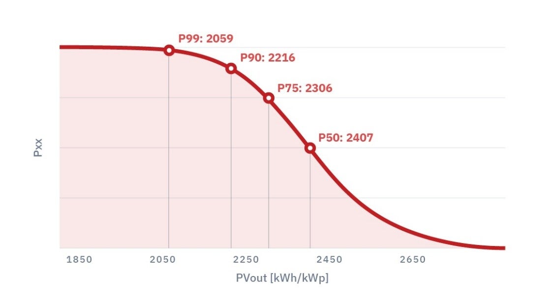

The P50 yield—the annual energy production estimate that has a 50% probability of being exceeded—is typically used as the expected production case. But investment committees also look closely at downside scenarios. They need to know whether the project still works if production is lower than expected, capital expenditure (CAPEX) increases, financing becomes more expensive, or merchant prices weaken.
This is where the relationship between P50 and P90 (the production level that has a 90% probability of being exceeded) becomes important. A project may show an attractive return under the P50 case. But if uncertainty is high, the P90 case may be significantly weaker. The wider the gap between expected and conservative production, the more fragile the investment case becomes.
Return on equity (ROE) is often presented as one figure, but in reality, it is more useful to see it as a range. The P50 ROE shows what the project may deliver under expected production. The P90 ROE shows what the investor might face under a downside production case, assuming other variables remain equal.
Reducing uncertainty may not change the expected yield. However, it can improve the conservative yield case and narrow the gap between P50 and P90 (Figure 1). That can make the downside return more resilient—often the case that matters most when investment decisions are being approved.
solar-pv-P50-P90-yield
1. The probability distribution of PV energy yield illustrates how expected yield decreases as the PXX level increases. Courtesy: Solargis
For investors, the question is not only how much the project can earn. It is also how much returns can deteriorate before the investment case becomes difficult to defend.

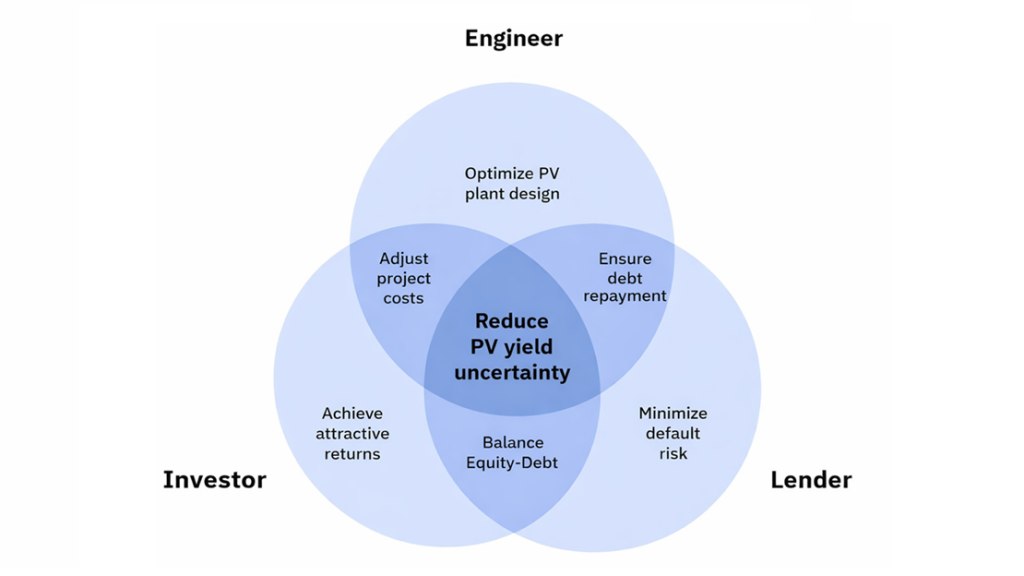

Closing the Gap Between Expected P50 and Bankable P90 Yield
Imagine a utility-scale PV project with a defined expected P50 yield. Under a standard approach, the project uses acceptable but limited inputs, simplified assumptions, and a conventional modeling process. The P50 yield may look strong, but the uncertainty range is relatively wide. As a result, the P90 yield sits noticeably lower.
The project may still be financeable, but only within tight limits. The lender sizes debt conservatively to protect DSCR. The investor sees a weaker downside return. The engineer has less room to justify more optimized design choices.
Now imagine the same project with better solar resource data, longer historical time series, more realistic modeling, higher temporal resolution where relevant, and stronger validation of site-specific losses. The P50 yield may remain the same. But uncertainty falls, and the P90 yield improves.
Nothing physical has changed. The site is the same. The equipment may be the same. The expected production has not increased.
What has changed is confidence. That confidence can create more headroom in the financial model. It can strengthen the downside return case. It can support more efficient debt sizing. It can also give engineers a stronger basis for design optimization. In other words, reducing uncertainty can improve the project without increasing the expected yield (Figure 2).
PV-yield-uncertainty
2. Reducing PV yield uncertainty is beneficial for each stakeholder’s objective. Courtesy: Solargis
