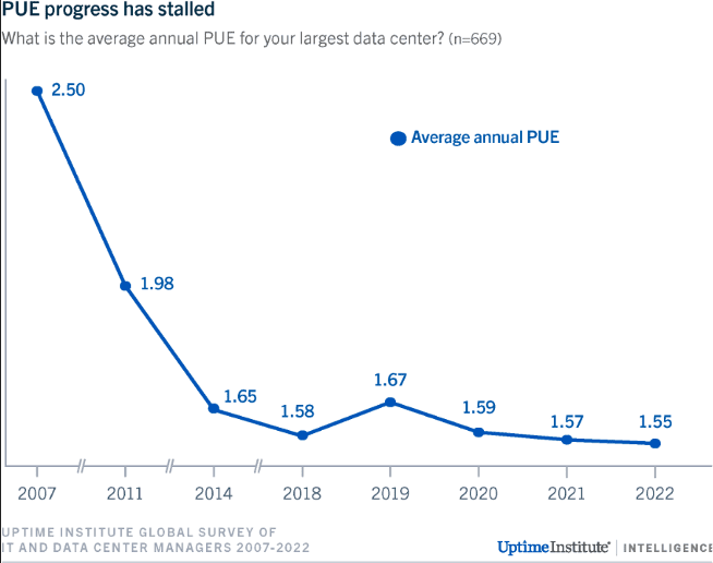

Over the past decade, the average PUE of data centers has seen notable improvements. In 2007, the average PUE was approximately 2.5, indicating that for every watt used for information technology (IT) equipment, an additional 1.5 watts were consumed by overhead systems like cooling and lighting. By 2013, this average had improved to about 1.65. However, progress has plateaued in recent years, with average PUE levels remaining mostly flat for the fifth consecutive year (Figure 1), though the average obscures advances in newer, larger facilities.
1. Power usage effectiveness (PUE) measures data center energy efficiency. A value of 1.0 signifies perfect efficiency, while higher values indicate greater consumption, often due to cooling equipment. Courtesy: Uptime Institute
