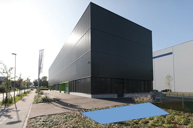

2. Inlyte Energy is partnering with NTS Colocation AG to deploy long-duration energy storage across NTS facilities, beginning with an installation at the NTS Tier 4 Data Center Pilot Site in Bern, Switzerland. The blue box in the photo outlines where the 600-kWh project, targeted for commissioning by the end of this year, will be deployed. Inlyte and NTS have agreed on a plan to deploy up to 2 MW of iron-sodium battery capacity by 2028. Courtesy: Inlyte Energy
Inlyte Energy is partnering with NTS Colocation AG to deploy LDES across NTS facilities, beginning with a pilot installation at its data center (Figure 2) in Bern, Switzerland. The companies have agreed on a plan to deploy up to 2 MW of iron-sodium battery capacity by 2028, starting with a 600-kWh installation targeted for commissioning at the end of 2026. The companies said the collaboration underscores both companies’ commitment to advancing resilient, sustainable energy infrastructure tailored to the unique constraints of the Swiss data center market, while showcasing global scalability.
