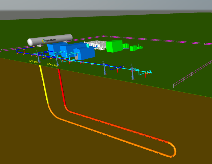

A rendering of Rodatherm’s closed loop power generation facility. Courtesy: Rodatherm

A rendering of Rodatherm’s thermodynamically closed loop system drilled into Earth’s heat reservoir. Courtesy: Rodatherm

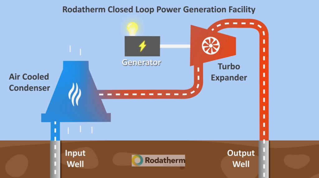

POWER: Rodatherm is developing a system designed to achieve a competitive levelized cost of energy, with zero emissions, no water usage, and the ability to provide secure energy close to demand centers. Can you talk a bit about the technology and engineering behind this system, and why it’s important to growth in the geothermal sector?
Cook: Almost all geothermal technologies and companies rely on water as a working fluid. The problem is that water is a poor refrigerant; the process is inefficient with high operating costs—in short, poor cash flow. Further, sourcing sufficient groundwater limits geothermal applicability to remote areas. Electrical loads generally coincide with high-density population areas with stressed groundwater resources.
The Rodatherm system is essentially water-free geothermal. The system relies upon an organic working fluid that is efficient (50% more power output than water-based systems) with low operation costs. Simply put, the technology is a method to efficiently generate power from heat, analogous to a heat pump. Rodatherm’s solution can be applied broadly, close to demand loads, and geologically co-located with traditional reservoirs, enhanced reservoirs, or ideally with existing sedimentary basins.
