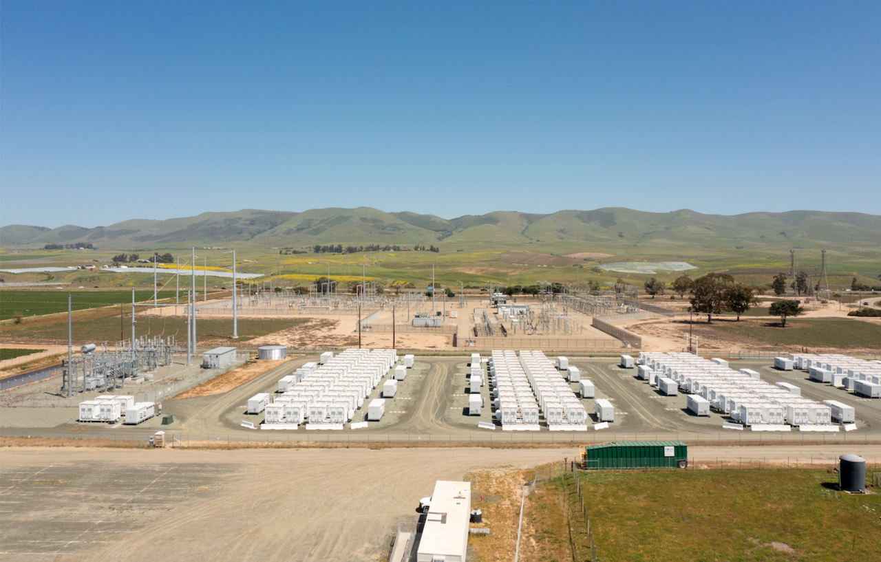

Caballero (Figure 1) is in Nipomo, San Luis Obispo County, California, roughly 90 miles south of the Moss Landing facility whose January 2025 fire drew national scrutiny to utility-scale lithium-ion storage. Caballero was amid hot commissioning during this event and took steps to reflect on lessons learned from that incident in a county that was highly attentive.
Caballero-battery-energy-storage-system-BESS-AOP
1. The Caballero battery energy storage site is a 100-MW/400-MWh system in Nipomo, San Luis Obispo County, California. Courtesy: Alpha Omega Power (AOP)
Developed by Alpha Omega Power (AOP), a BESS-focused independent power producer, Caballero operates under a resource adequacy (RA) contract with a California load-serving entity, and earns additional revenue from the CAISO markets. Although Caballero can deliver up to 465 MWh, AOP conservatively rates it at 400 MWh. The four-hour duration profile was selected specifically to qualify for RA procurement, a design decision addressed in the duration sizing section below.

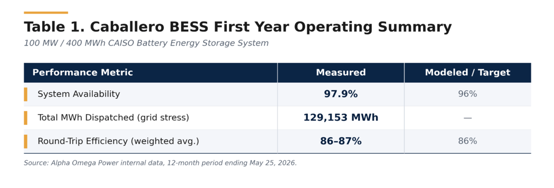

The table below summarizes Caballero’s measured performance across the first 12 months of commercial operation.
Availability held at 97.9% across the period, supported by a rolling planned-maintenance strategy that caused minimal operational disruption. Round-trip efficiency was in the 86%–87% range. Response time to CAISO automatic generation control (AGC) dispatch signals was well within the grid operator’s required window.
These results place Caballero among the strongest-performing BESS assets in CAISO for availability, reliability, and energy-arbitrage performance.
