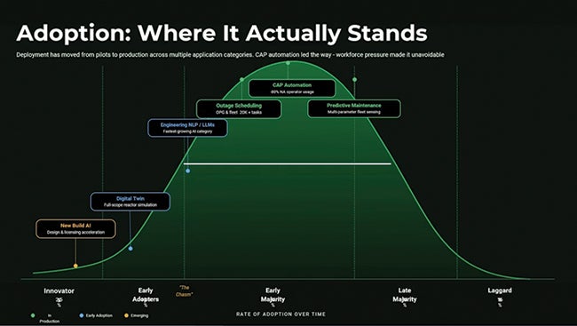

1. Artificial intelligence (AI) adoption in nuclear maintenance has moved past the chasm for corrective action program (CAP) automation, which has reached about 80% North American (NA) operator usage. Outage scheduling and predictive maintenance are in the early majority, while digital twins and new-build AI are in early adoption. Courtesy: Nuclearn AI / CERAWeek 2026
The first major wave of AI in nuclear focused on equipment prediction (Figure 1). “Primarily, what we’ve done as a company and what a lot of people are doing, we started with equipment predictions—when is equipment going to fail, how do we predict failure performance?” Fox said. “We call that automated pattern recognition, using statistics to predict equipment failures.” He noted that work has been underway for 20 to 25 years, progressing from simple statistical forecasts to machine learning systems and now to full AI that combines text and time-series data to generate maintenance recommendations and failure probability assessments.
The application that drove the most recent wave of adoption, however, was corrective action automation. Each reactor generates 5,000 to 7,000 equipment issue tickets per year, a volume that “overwhelms the staff that are responsible for correcting them,” Fox said. AI systems now handle intake, classification, and routing without requiring senior engineering time for triage. Almost every nuclear utility in the U.S. runs some form of automated corrective action AI, he noted, as does the entire Canadian fleet.
Preventive maintenance in nuclear has also extended into outage planning. A single refueling or maintenance outage involves 15,000 discrete activities, Fox said. “AI is pretty good at backfilling that—am I missing a task here, there?—especially as I turn over that scheduling stuff to younger folks that maybe don’t have the experience necessary,” he said. Robotics is also entering the picture. Spot robots equipped with radiation sensors are already crawling plants, generating 3D radiation maps to help maintenance teams plan work that minimizes dose exposure for specialized workers, such as nuclear welders, who operate under federally capped dose limits, Fox noted.
