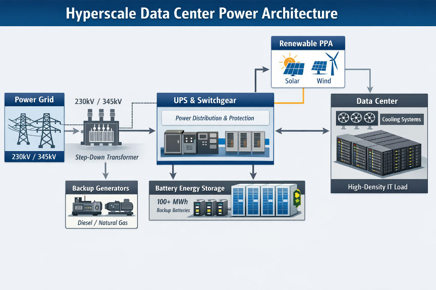

Technical Grid Architecture. A dedicated high-voltage substation connected to multiple 230-kV or 345-kV transmission feeds is needed for a 400-MW hyperscale campus. Before reaching the server racks, large step-down transformers distribute power to medium-voltage switchgear that feeds uninterruptible power supply (UPS) systems, battery storage, and power distribution units. It’s crucial that utilities design connections with N-1 reliability so that if any equipment fails, it will not disrupt the campus.

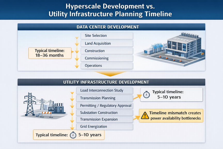

Interconnection Queue Challenges. We are seeing a rapid rise in large-load interconnection queues with several U.S. grid operators. The combination of new-generation projects and industrial consumers’ requests for hundreds of megawatts of capacity poses a new challenge for utilities. Long-term load forecasting is now complicated, and utilities must now sequence transmission upgrades years in advance (Figure 1).
data-center-transmission-timelines
1. Hyperscale data centers can be sited, built, and commissioned in 18–36 months, while the transmission infrastructure needed to power them typically requires 5–10 years to plan, permit, and energize. This timeline mismatch is a primary driver of power availability bottlenecks. Courtesy: hi-tequity

data-center-power-architecture
2. A hyperscale campus can draw from three power sources—the utility grid, on-site backup generation, and renewable power purchase agreements (PPAs)—converging at the UPS and switchgear that feed servers and cooling. Battery storage exceeding 100 MWh can be used to bridge grid disturbances and shape load. Courtesy: hi-tequity
