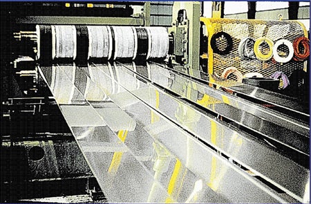

Step 1: Slit the coils
The coils are slit in a continuous process to a width needed to make the desired tube hollow size (Figure 1). The slitting process is designed to develop a square edge that's optimized for the square butt weld commonly used in manufacturing welded tubular products.
1. Cut stock to width. Stainless steel coils are split to the required width to begin the manufacturing process. Courtesy: Plymouth Tube
