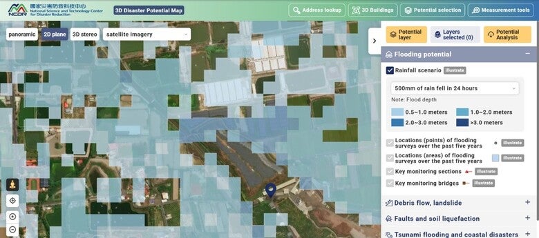

During the site evaluation phase, project teams integrate historical meteorological datasets, advanced academic modeling tools, and publicly available government data to assess both climatic and geotechnical risks. For flood risk analysis, flooding potential maps and soil liquefaction maps published by the National Science and Technology Center for Disaster Reduction (NCDR) are extensively utilized (Figure 1). These datasets enable a retrospective assessment of flood occurrences over the past five years and support scenario-based simulations of extreme rainfall events, such as cumulative precipitation of 500 millimeters within a 24-hour period. Such analyses provide critical insights into potential flood depths and soil liquefaction susceptibility. To complement these regional-scale assessments, site-specific geotechnical investigations are conducted to validate subsurface conditions. These investigations typically include soil drilling and standard penetration tests (SPTs), which provide essential information on soil density, stratification, and groundwater levels. The resulting data serve as key inputs for foundation design, particularly in areas characterized by soft soil conditions or high groundwater tables.
flooding-risk-assessment
1. Flooding potential map from the NCDR for site risk assessment. Courtesy: ECOVE Environment Services Corp.
For sites identified with high flood vulnerability, a series of engineering adaptation measures are incorporated during the design phase. These include the implementation of stormwater diversion and detention systems, elevation of foundation structures, and raising of electrical equipment platforms to effectively mitigate localized flooding during extreme rainfall events.

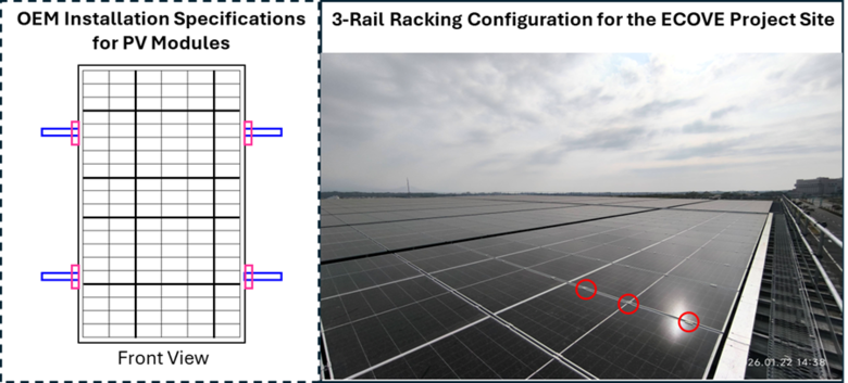

To further enhance system resilience, mounting configurations are designed to exceed the original equipment manufacturer (OEM) specifications for two-rail installation. In practice, a three-rail racking configuration is adopted to reduce localized stress concentrations and enhance overall structural stability. This configuration facilitates more effective load distribution, thereby mitigating bending moments and occurrence of wind-induced vibrations. As a result, the risk of module deformation, uplift, or detachment under extreme wind conditions is significantly reduced (Figure 2).
solar-pv-installation
2. Three-rail mounting configuration for PV module installation. Courtesy: ECOVE Environment Services Corp.

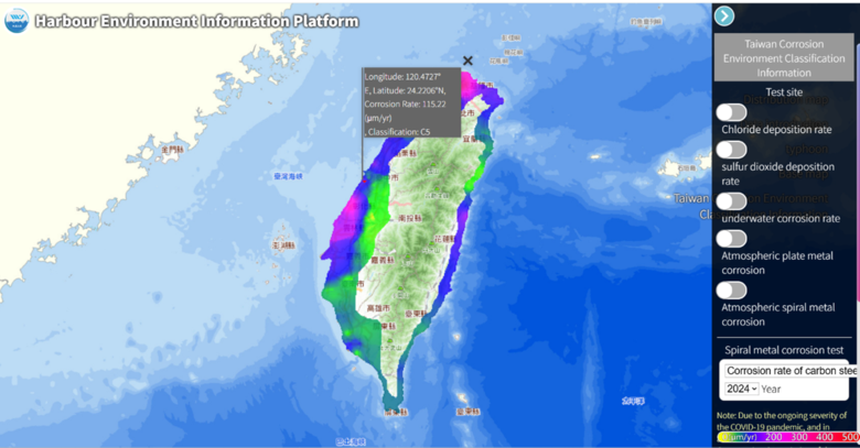

Material durability is equally critical, particularly for coastal installations exposed to salt-laden environments. Site-specific corrosion risk is assessed using the Harbor Environment Information Platform issued by the Institute of Transportation, Ministry of Transportation and Communications (MOTC), Taiwan (Figure 3), which provides a basis for evaluating salt spray corrosion levels and guiding material selection. For environments classified as C4 or higher, indicating high corrosion exposure, mounting structures are typically fabricated using aluminum-magnesium-zinc coated steel. The coating thickness is further specified based on the severity of the corrosive environment to ensure adequate long-term corrosion resistance. Fasteners are selected as 304 or 316 stainless steel to enhance resistance to oxidation and ensure long-term durability. These material strategies play a vital role in preserving structural integrity and extending the service life of solar power plants operating under harsh environmental conditions.
corrosion-assessment-solar-pv-installation
3. Corrosion assessment on the Harbor Information Mapping Platform, MOI. Courtesy: ECOVE Environment Services Corp.

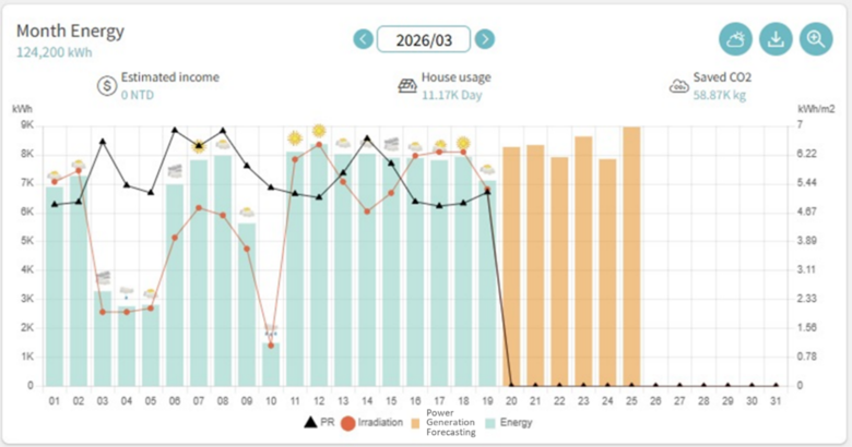

Each corrective action is further incorporated into a structured lessons learned framework, enabling continuous improvement of O&M strategies. In recent years, conventional monitoring systems have been upgraded into intelligent platforms equipped with artificial intelligence (AI)–based early warning and structural monitoring capabilities. This transition represents a shift from reactive alarm-based systems to predictive, data-driven asset management. By leveraging AI models to analyze historical operational data, degradation trends in PV modules can be effectively identified, enabling early detection of string-level anomalies. This allows potential faults to be addressed proactively before impacting energy generation performance (Figure 4).
solar-pv-production
4. AI-driven intelligent O&M system. Courtesy: ECOVE Environment Services Corp.
