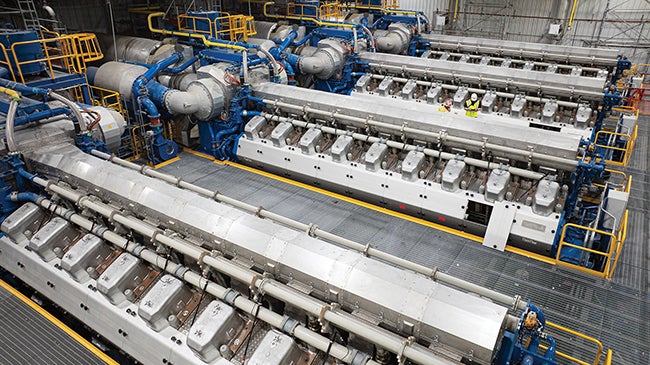

Once all 10 Wärtsilä gensets were in place (Figure 1) in late August 2024, mechanical and electrical crews joined the around-the-clock push, ultimately installing more than 50,000 linear feet of piping and pulling nearly 600,000 linear feet of cable. With the 10 gensets and their auxiliary equipment nearly identical, Fagen assigned just two mechanical teams to work through all 10 units in sequence—a deliberate choice that let lessons learned on each genset carry directly into the next, raising productivity while holding quality. As each unit’s engine-out work wrapped, crews tied in balance-of-plant systems for lube oil, natural gas, cooling water, compressed air, and service water, along with engine-specific electrical and instrumentation work.
1. Timmerman Unit 1 runs on 10 Wärtsilä 18V50SG reciprocating engines, a technology chosen around the world for its fast-start flexibility. Courtesy: Fagen Inc.
