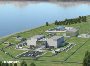

Operating pressure is another fundamental consideration. Technologies that operate at or near atmospheric pressure can reduce the need for the extensive high-pressure-rated vessels, piping, valves, pumps, actuators, and associated systems that high-pressure designs require—reducing the quantities of commodities and specialized materials needed for construction, along with construction complexity, duration, and exposure to supply chain constraints. These benefits extend beyond pre-COD capital to the full post-COD cost profile.
