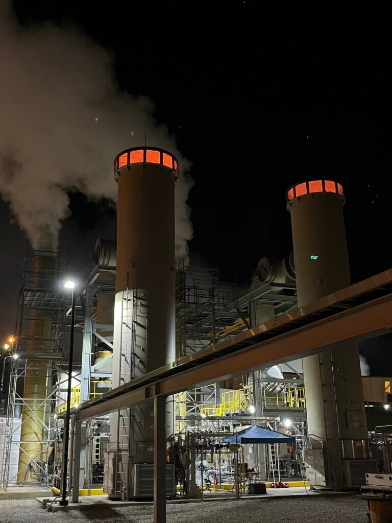

At NRG Energy’s WA Parish Unit 8 in Texas, two redundant Heartland Concentrators—each sized for 50,000 gallons per day—use direct-contact thermal evaporation to reduce FGD wastewater volume and route the concentrated residual into the plant’s existing gypsum-handling system. Successful implementation required consideration of wastewater chemistry, utilities, air permitting, residuals management, existing infrastructure, construction constraints, and operating requirements. Courtesy: NRG Energy

The two redundant Concentrators provide operating flexibility and reliability. Their direct-contact design is intended for the solids burden inherent in high-total-dissolved-solids wastewater.
“Heartland’s approach is designed around the reality that high-TDS wastewater will contain—and, as it is concentrated, generate—significant amounts of dissolved and suspended solids,” the team said. “Rather than relying on conventional heat-transfer surfaces that can become coated with scale, the Concentrator brings the wastewater directly into contact with hot gas in a low-temperature, high-turbulence evaporation zone.”
As water evaporates, non-volatile dissolved and suspended constituents remain in a smaller concentrated residual stream. Large liquid droplets enter the turbulent hot-gas stream, creating a dynamic liquid–gas interface that maximizes heat transfer while limiting solids deposition. “The process intentionally maintains relatively large liquid droplets and avoids drying them into fine particulate,” the team said. “The resulting vapor stream then passes through a high-efficiency, three-stage mist eliminator, where entrained droplets and particulate matter are captured and returned to the process rather than carried to the exhaust stack.”
Controlled recirculation further concentrates the residual, while periodic purge manages solids loading. Periodic washing and flushing remove accumulated salts.
At WA Parish, evaporation leaves a much smaller residual volume containing the concentrated non-volatile constituents from the wastewater. That residual is ultimately managed through the plant’s gypsum-handling system, allowing the ZLD strategy to use existing solids handling instead of creating another wastewater stream requiring separate treatment.
“One of the strengths of the project is that this was accomplished without wholesale changes to the plant,” the team noted. Connections include natural gas, electrical power, wastewater feed, and residual discharge. The team also added an ultra-low-nitrogen oxides (NOx) flare specifically for the installation.

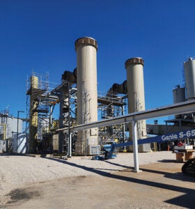

“Interestingly, some of the biggest challenges were not related to the evaporation technology itself. They were the practical realities of building a new treatment system inside an operating power plant,” the team said.
Because the Concentrators’ compact footprint allowed the units to fit beside existing water-treatment facilities, it reduced utility-routing distance and cost. “No significant modifications to the existing process were required,” the team noted. Buried utilities and field coordination, however, required close collaboration, and mandatory safety standdowns during lightning storms affected construction.
Still, the installed system remained substantially consistent with the original design. Changes made during execution were “relatively minor” and primarily related to health, safety, and environment observations.
“One involved accessibility to burner components located within the enclosed skirt of the low-NOx flare,” the team said, noting that future designs will make those components easier to access. “Another involved the residuals thickener underflow pump. It was designed to accommodate very low flow rates, but future designs can optimize pump size, duty cycle, and flushing velocity while preserving that turndown capability.”

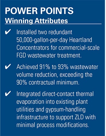

The Concentrators achieved nameplate performance during startup and have performed as designed. Actual wastewater volume reduction has averaged approximately 91% to 93% to date, exceeding the 90% contractual minimum.

“Perhaps most importantly, the project shows that a major reduction in FGD wastewater volume can be integrated into an existing coal plant without requiring wholesale changes to the facility,” the team underscored. “The two 50,000-gallon-per-day Concentrators were incorporated largely using existing plant utilities and wastewater infrastructure. That makes WA Parish a useful real-world reference for other plants facing similar decisions.”
