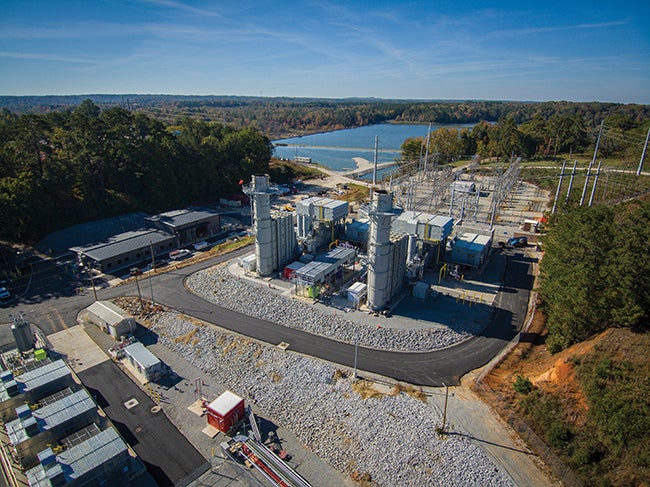

For more than a century, the Parr site along South Carolina’s Broad River has done whatever the grid needed it to do next. It began as a run-of-river hydro plant powering Columbia’s electric streetcars. It added a coal-fired steam unit in the 1920s to firm up that hydro output. It hosted one of the nation’s first civilian nuclear reactors. And for decades, it leaned on a set of aging GE Frame 5 combustion turbines for peaking power and black start support.
Now Dominion Energy South Carolina (DESC) has retired those Frame 5 units and replaced them with two GE Vernova LM6000 PF+ aeroderivative combustion turbines—part of a broader peaking modernization program that gives the utility fast-start, dual-fuel, black start, and synchronous condensing capability at a moment when solar has become the variable resource the system needs to manage, rather than hydro in the early 20th century.
“The Parr project was undertaken as part of an overall ‘peaking modernization’ strategy and portfolio of projects for DESC,” Andrew Walker, DESC’s director of generation development and planning, told POWER. That strategy retired nine older simple-cycle units—GE Frame 5s at Parr and Westinghouse 191 and 251 units at DESC’s Bushy Park, Hardeeville, and Coit sites—across four locations, consolidating and modernizing the utility’s peaking fleet in the process.
A Sister Project at Bushy Park
The Parr units didn’t arrive alone. DESC contracted the Parr and Bushy Park projects simultaneously, with GE Vernova supplying major equipment and Burns & McDonnell serving as engineering, procurement, and construction (EPC) contractor for both. A single LM6000 PF+ unit at Bushy Park, in Berkeley County, entered commercial operation in November 2024—notable, Walker said, as GE Vernova’s first LM6000 VELOX unit, the manufacturer’s third generation of that packaging, to reach commercial operation. The two Parr units followed in December 2025. Walker described the pairing as DESC’s first new generation project since the Jasper Station combined-cycle plant entered commercial operation in 2004, underscoring how long it had been since the utility last built new generating capacity of any kind.

Construction wasn’t without its complications. Crews doing early foundation work encountered undocumented fill material and buried structures left over from the original Parr Steam Plant’s coal unloading, storage, and handling facilities—a legacy of the site’s long operating history working against the modernization effort. The project team mobilized quickly to excavate, demolish, and remove the structures and bring in clean fill, a more difficult task than it might otherwise have been given the site’s small footprint, its single access road, and its proximity to a Class I railroad mainline that has to be crossed at grade to enter or exit the property. Walker credited close coordination between DESC’s operations, project construction management, and environmental teams—along with contractor crews able to be redeployed from work at other sites that was concluding—with keeping the project on schedule.
