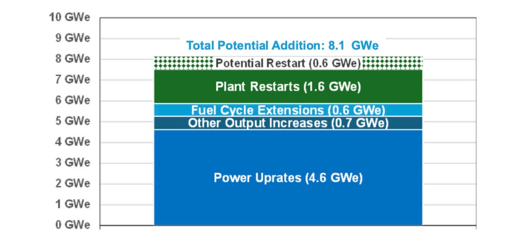

The measure aligns with industry interest, as reported by the Nuclear Energy Institute (NEI) in its Future of Nuclear Power survey, released in September 2025. NEI reported that more than 95% of the 95 units it surveyed expect to operate for at least 80 years, and that more than 73% of U.S. sites have some level of interest or planning for power uprates. The survey also found that about 48% of sites are pursuing at least one “enabling” change—risk‑informed LOCA (updating loss‑of‑coolant accident analyses to free up safety margin for uprates and longer cycles), extended fuel cycles using conventional fuel, or extended fuel cycles using accident‑tolerant fuel—slated mainly for the 2026–2034 period.
Notably, NEI concluded that uprates, restarts, longer cycles, and other output increases together could add over 8 GWe of new carbon‑free nuclear capacity over the coming decade.
The Nuclear Energy Institute’s (NEI’s) 2025 Future of Nuclear Power survey estimates more than 8 GWe of potential additional nuclear capacity from the existing fleet this decade, driven primarily by power uprates, plant restarts, fuel‑cycle extensions, and other output increases.Courtesy: Nuclear Energy Institute (NEI), The Future of Nuclear Power 2025 Survey.
The Nuclear Energy Institute’s (NEI’s) 2025 Future of Nuclear Power survey estimates more than 8 GWe of potential additional nuclear capacity from the existing fleet this decade, driven primarily by power uprates, plant restarts, fuel‑cycle extensions, and other output increases. Courtesy: Nuclear Energy Institute (NEI), The Future of Nuclear Power 2025 Survey.

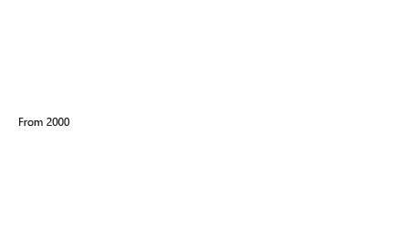

The NRC’s own backgrounder notes that, historically, 171 approved uprates have already added about 8.5 GWe of electric capacity to the U.S. grid—the equivalent of roughly eight large reactors—at a fraction of the cost of new‑build. For current reviews, the agency has set internal targets of 12 months for extended power uprates, nine months for stretch uprates, and six months for MUR uprates.
U.S. Nuclear Regulatory Commission (NRC)–licensed power uprates at U.S. reactors have added about 8.5 GWe of cumulative capacity since 2000, based on NRC data and projections for uprate submittals through 2032.Source: NRC (Jan. 2025)
U.S. Nuclear Regulatory Commission (NRC)–licensed power uprates at U.S. reactors have added about 8.5 GWe of cumulative capacity since 2000, based on NRC data and projections for uprate submittals through 2032. Source: NRC (Jan. 2025)
