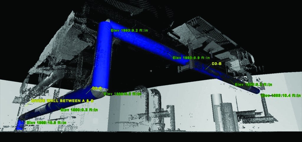

The precision the project required was borne from a high-tech approach, both Rickman and Bracall noted. The team began eight months before getting into the field, spending countless pre-outage hours identifying and addressing challenges using a 3-D ACAD solid model custom-developed by Engineered Rigging. The model used laser scanning to create a point cloud for all areas of the workzone, providing exact scaling to identify interferences, clearance dimensions, and obstructions. Animation, meanwhile, allowed project partners to visualize the travel path, the detailed lift plan (and configure exact lift heights), rotation, plane adjustments, and exact areas of closest obstacles to allow placement of spotters. The modeling was also crucial for safety by pinpointing worker placement and allowing the project team to visualize how the work could quickly and safely be completed in high-radiation areas.
“Scanning and modeling is used widely across the industry, but the method we used—we built a fully animated model so you could actually watch the project and the animated model months before we actually did anything in the field—that approach was innovative,” Rickman said. The project also used metrology technology, integrated with misalignment data that was identified before the outage, for detailed mapping of specific bolt-hole alignment. That approach also proved spot-on. “We were able to set those FWHs right down on the 24-inch bolts that holds it to the pedestal,” Rickman said.

To counter the space constraints, Engineered Rigging’s team of eight in-house engineers also came up with a temporary lift device (TLD), which incorporated two 200-ton capacity computerized strand jacks and eight 50-ton wheel trucks (Figure 2). But because it could be remotely operated (through cameras used to monitor and perform finite movements), and offered an x-, y-, and z-axis of control (through millimeter-measured hydraulic movement), it proved crucial to efforts to lift, remove, and replace each FWH.

“In an effort to reduce schedule and risk, we wanted to be able to lift the FWHs vertically and then place them on a track system so we could safely get them from vertical to horizontal, and the TLD allowed us to gain enough headroom between the ceiling and the [girders] and the height of the FWH to lay it down,” said Rickman. Precision here, too, was key. “If we had used traditional cranes, we’d [have] had to remove a significant amount of interferences, and it would have increased the project schedule. And it allowed us to remove those heaters without taking the [asbestos] insulation off, which would have otherwise required an asbestos abatement project and increased the time, cost, and risk.” Rickman credited D&Z with finding and ensuring the custom-made solution would fit the project’s needs. “It was an approach none of the other parties brought to the table,” he noted.
