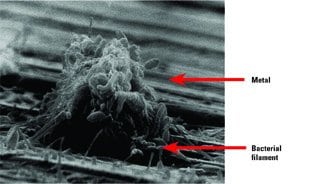

  • Microbiological fouling by bacteria naturally occurring in water. As the bacteria attach to the base metal of tube surfaces (Figure 2), they form a thin film of slime that grows and traps other particulates, further reducing heat transfer.
    2.	Hungry critters. Bacterial attack of tubes' base metal is a problem that can be just as serious as nonbacterial pitting or deposition. Courtesy: Conco Systems Inc.
    2. Hungry critters. Bacterial attack of tubes’ base metal is a problem that can be just as serious as nonbacterial pitting or deposition. Courtesy: Conco Systems Inc.

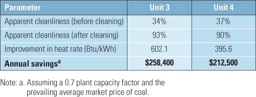

This is where Howell’s 20 years of experience with tube analysis comes into play. His examinations of tubes and foulants in the laboratory identify the source and impact of the problem. Once those have been determined, he hires a company like Conco Systems to clean house. Conco’s experts can determine whether the foulant can be removed by a simple condenser back-flush or whether the unit needs to be taken off-line so the tubes of its condenser can be more thoroughly cleaned by mechanical scrapers.

Last but certainly not least on the list of mechanical cleaning options is using a scraper powered by pressurized water (see box). Over the years, this method has become more effective as cleaning specialists have sized scrapers to match the inner diameter of tubes, allowing them to be cleaned right down to the base metal.
5.	Who ya gonna call? The Cal-Buster tube cleaner from Conco Systems Inc. contains carbide blades that score calcite scale—much as a glass cutter cuts glass. Courtesy: Conco Systems Inc.
6.	Suction, please. Conco's C3S tube cleaner follows up on the work of the Cal-Buster by removing scored scale, leaving the inside of tubes shiny and clean. Courtesy: Conco Systems Inc.
6. Suction, please. Conco’s C3S tube cleaner follows up on the work of the Cal-Buster by removing scored scale, leaving the inside of tubes shiny and clean. Courtesy: Conco Systems Inc.
An example of this kind of scraper is Conco Systems’ "Cal-Buster" tube cleaner (Figure 5). Mounted on its Teflon body are several rotary carbide cutters. Because the cutters are placed at different angles, the tool can fully cover the interior of the condenser tube into which it is inserted. A plastic disk propels the Cal-Buster through the tube and fractures the eggshell-like crystalline form of calcium carbonate. Once the Cal-Buster has done its job, a heavier-duty device such as the Conco C3S tube cleaner (Figure 6) is used to remove the dislodged calcite, leaving the inner tube surface free of corrosion-causing deposits and scale.
