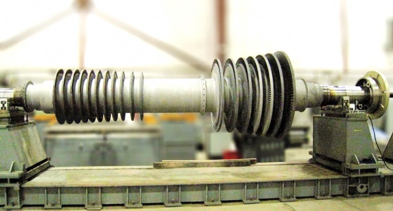

2. On the half-shell. Dairyland replaced an entire high-pressure/intermediate-pressure turbine at its J.P. Madgett Station to improve the plant’s performance and reliability. Courtesy: Dairyland Power Cooperative, John P. Madgett Station

Dairyland Power Cooperative (DPC) and Siemens Power Generation (Orlando, Fla.) recently completed a retrofit of the high-pressure (HP), intermediate-pressure (IP), and low-pressure (LP) steam paths of Unit 1 of Dairyland’s J.P. Madgett Station in Alma, Wis. Madgett Station is a coal-fired subcritical steam plant that entered service in 1979 with a nominal rating of 365 MW. Retiring the unit wasn’t an option, because DPC resource planners realized they need its capacity now and for another 30 years. Modernizing the steam turbine was the only feasible strategy. DPC initiated the retrofit project with three aggressive goals: improve the efficiency of the plant across the load range, boost unit capacity, and lengthen the turbine’s maintenance period to 10 years.
Siemens provided a retrofit upgrade package that included new rotors, inner casings, and high-efficiency rotor and stator blades, as well as design and installation services. A 50-day outage was scheduled in the fall of 2004 to complete the retrofit work in parallel with major boiler maintenance, upgrading the control system to a modern distributed control system, and replacing the main transformer to handle the expected higher power output.
Siemens’ BB44FA (full arc) HP/IP turbine retrofit package targets the existing fleet of Westinghouse building-block (BB) 44 turbines with inlet pressures up to 2,400 psig and an inlet temperature of 1,000F. BB44 turbines range in size between 350 MW and 680 MW. By using the package, engineers can add a full arc to the admission inlet section, eliminate the 180-degree steam turnaround to the HP blade path, eliminate the impulse control stage, add a fully integral inner casing, and improve steam sealing (Figure 2).
All internal stationary components were put within a single, fully integral casing—a design that minimizes parts count and decreases installation time and the duration of future outages. The BB44FA design duplicates the mating-flanges profile of existing units, enabling reuse of the outer casing and all the anchor points. This exemplifies Siemens’ design philosophy for the retrofit package: to make it completely "plug-and-play."
The design of the HP/IP rotor design features fully integral, no-bore forging to shorten start-up times and lengthen fatigue life. Like the outer casing and anchor points, bearings can be reused because the new rotor matches the weight of the old one, reducing cost and installation time. Blade designs featuring integral shrouds were selected to optimize thermodynamic performance. The shroud design has two advantages: The shroud creates a circumferential boundary for the steam path, enabling the retrofit of more-efficient seals, and it provides individual blade tip supports between adjacent blades. The designs of the first-stage HP and IP blades reduce rotor inlet temperatures while providing favorable downstream flow conditions.

The upgraded turbine was successfully installed during the scheduled 50-day outage of J.P. Madgett Station. Test results were exceptional: The efficiency of the HP turbine increased by 8% to 10% over the load range while that of the IP section rose 2% to 4%. Total plant output went up 20 to 27 MW. Much of the measured 7- to 8-MW performance gain in the LP section was attributed to the improved front end blade design, the 25% increase in annulus area, and the more-efficient last three stages of the LP section.
