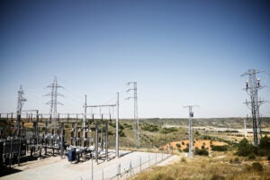

90 Seconds from Normal to Blackout
The morning of April 28, 2025, was unremarkable. Solar and wind generation were within normal ranges for the season. Spain was exporting about 5 GW of electricity. Voltage levels on the 400-kV transmission network were mostly within bounds, though variability had been increasing since about 9:00 a.m.
Two episodes of power system oscillations occurred in the half hour before the collapse. The first, between 12:03 p.m. and 12:08 p.m., was a converter-driven forced oscillation at 0.63 Hz, primarily affecting the Iberian Peninsula. The second, from 12:19 p.m. to 12:22 p.m., was a classic inter-area oscillation at 0.2 Hz—the well-known East-Centre-West mode of the Continental European grid, in which large areas swing against each other.
TSO operators in Spain and France took measures to dampen these oscillations, including reducing cross-border exports and reconnecting internal transmission lines. These measures worked for the oscillations, but had the side effect of pushing voltages higher in the Iberian system.
By 12:32 p.m., voltages had settled below 420 kV and the oscillations had subsided. What happened next unfolded with terrifying speed.
From 12:32:00 p.m. onwards, voltages at numerous nodes began rising. About 500 MW of large renewable generation in Spain reduced output, and because these plants operated in fixed power factor mode, their reactive power absorption dropped proportionally, further boosting voltage. An additional 208 MW of distributed wind and solar units either ramped down quickly or disconnected for unknown reasons. Net load in distribution grids increased by roughly 317 MW, partly attributed to small rooftop photovoltaic (PV) systems tripping on overvoltage protection.
At 12:32:57 p.m., a 400/220-kV transformer near Granada tripped on overvoltage protection, severing 355 MW of generation from the grid. At 12:33:16 p.m., two substations near Badajoz lost 727 MW of PV and thermo-solar capacity. Between 12:33:17 p.m. and 12:33:18 p.m., another 928 MW of wind and solar generation disconnected across several regions. In total, more than 2.5 GW of generation vanished in roughly 78 seconds.
Each disconnection removed reactive power absorption from the system, pushing voltages still higher and triggering the next round of disconnections. By 12:33:19 p.m., Spain and Portugal began losing synchronism with the rest of Europe. Automatic load shedding and system defense plans activated as designed, but could not arrest the cascade. The alternating-current (AC) interconnections to France tripped on out-of-step protection at 12:33:21 p.m. The link to Morocco had already disconnected on underfrequency. The high-voltage direct-current (HVDC) line to France, still pushing power in constant-power mode, was the last connection to sever at 12:33:24 p.m. All system parameters collapsed.
