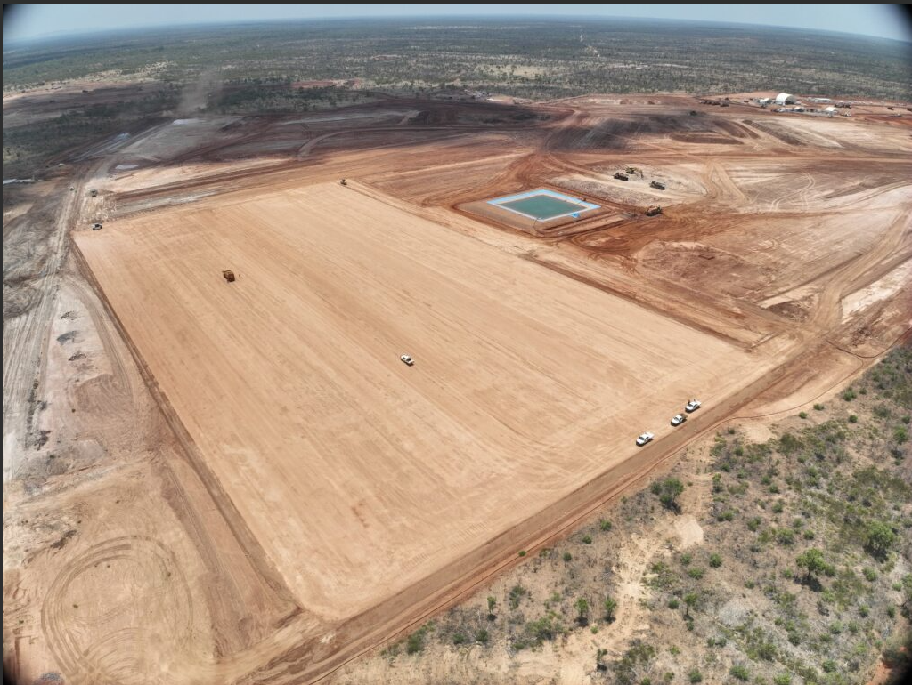

The Eva Copper Mine hybrid power project, located in Northwest Queensland, Australia, will include thermal power, along with solar and battery energy storage. Source: Aggreko
