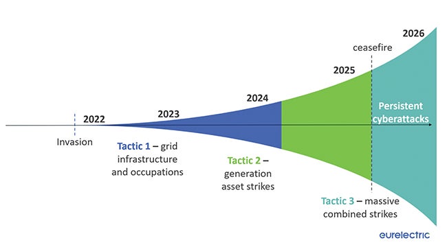

1. Russia’s attack tactics against Ukraine’s energy infrastructure have evolved through three distinct phases since the February 2022 invasion, spanning grid disconnection and occupation, to targeted generation asset strikes, to the massive combined drone-and-missile barrages that have dominated since late 2024. Cyberattacks have persisted across all three phases. Courtesy: Eurelectric, Battle-Tested Power Systems, February 2026.
Eurelectric’s analysis suggests Russia’s tactics evolved through three distinct phases (Figure 1). Artillery shelling gave way to drone and missile warfare, including Iranian-made Shahed drones—low-cost, GPS-guided one-way attack aircraft that detonate on impact, which Russia now mass-produces domestically under the designation Geran-2—and increasingly precise “double-tap” strikes. These are drones launched in volume to breach physical fortifications, followed by precision missiles to destroy the equipment behind them.
During the Ukraine War, initial focus on transmission substations shifted to centralized generation assets once Ukraine demonstrated it could reconnect a fragmented grid, the report says. By September 2023, more than 6,500 missiles and 3,500 drones had destroyed approximately 50% of Ukraine’s energy infrastructure and more than 67% of its thermal generation capacity, according to the Centre for Global Studies. The most recent phase, since September 2025, has been the most destructive. “The sheer number of munitions used means even with a 60–70% shoot-down rate, the few that get through remain fatal,” DTEK told Eurelectric.
The two most targeted assets, notably, have been gas compressors and primary electrical transformers, which are likely chosen for their system-critical role and long procurement lead times. Cyberattacks, meanwhile, have occurred constantly throughout all three phases, increasing 30% to 40% since the invasion began, according to DTEK, and are now accelerating given an artificial intelligence-driven arms race between Russian offensive models and Ukrainian defensive systems.
