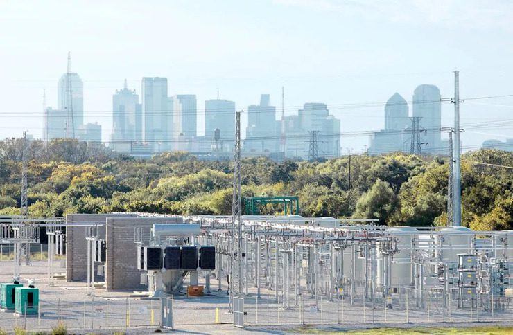

Technology exists to address these issues. These range from simple capacitors to static VAR compensators (SVCs, Figure 1) and from static synchronous compensators (STATCOMs) to advanced electrical systems. Some also utilize old generators by turning them into synchronous condensers (Figure 2).
1. Static volt-ampere reactive (VAR) compensators, or SVCs, are one of many solutions used to prevent outages during times of high demand and stabilize grids that are increasingly reliant on renewable energy. Courtesy: Oncor

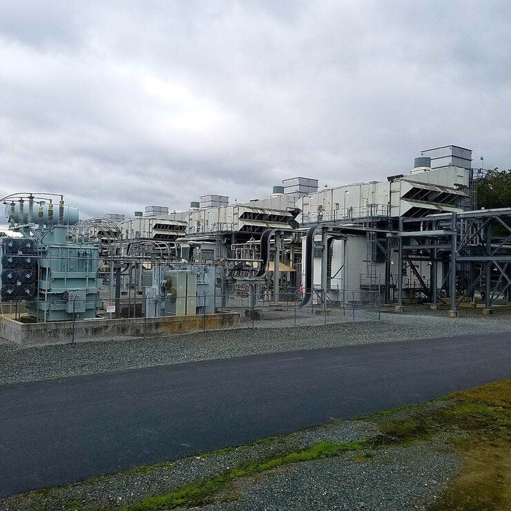

2. The Commonwealth Chesapeake Power Plant near the Virginia-Maryland border provides standby power to the local grid as well as providing synchronous condensing services and offering spinning reserve availability to the region. This was done by adding SSS Clutches to several of its GE LM6000 aeroderivative gas turbines. Courtesy: SSS Clutch
“Instead of retiring a coal or gas plant, it often makes financial sense to use old turbines to provide much needed services and stability to the grid,” said Morgan Hendry, president of SSS Clutch.

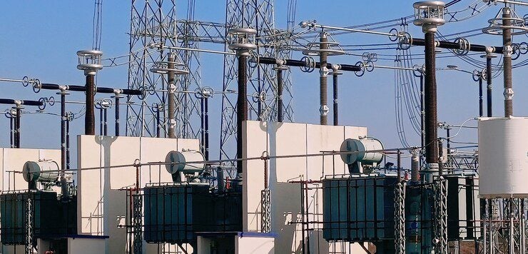

3. 765-kV shunt reactors. Courtesy: GE Vernova
“This equipment plays a crucial role in enhancing grid stability and efficiency, especially in the context of integrating large-scale renewable energy projects,” said Eric Chaussin, Power Transmission Business Leader of Grid Solutions, GE Vernova.

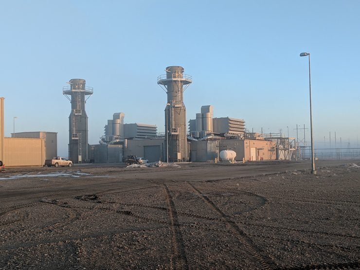

Similarly, gas turbine plants can add a clutch (Figure 5), so the machine is configured to both generate power when needed or provide grid support and ancillary services. Although the machine may mainly operate for synchronous condensing, the clutch can be reengaged to generate electric power if there is a sudden need for peaking power, as often happens in renewable-heavy grids.
5. The Sask Power Ermine plant in Canada is one of many adding SSS Clutches to GE LM6000 PF+ turbines to enable them to operate as synchronous condensers. Courtesy: SSS Clutch
