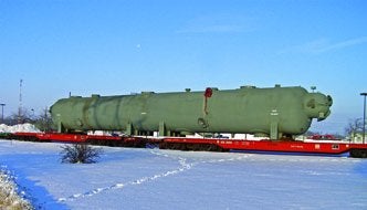

Thermal Engineering International (TEI) (USA) Inc. (Santa Fe Springs, Calif.)—a subsidiary of Babcock Power Inc. (Danvers, Mass.)—recently shipped two of the largest pressure vessels in the company's 90-year history. The pair of huge (13-ft-diameter, 110-ft-long) moisture separator reheaters (MSRs) were designed at corporate headquarters and built in TEI's factory in Sapulpa, Okla.
The 300-ton MSRs (Figure 3), which were sent to Detroit Edison's 1,100-MW Fermi 2 Power Plant and were scheduled to be installed last month, will improve the nuclear facility's reliability and efficiency. As John Austerberry, media spokesman for DTE Energy, Detroit Edison's parent, explains, "Because the MSRs will be used to dry and reheat the steam passing from the high- to the low-pressure turbine, we expect less erosion of LP turbine blades and an 8-MW boost in plant capacity as well."
3. But it's a dry heat. This moisture separator reheater is the largest ever designed by Thermal Engineering International (USA) Inc. It's so big that a special train had to be designed to ship it from Oklahoma to Michigan. Courtesy: Babcock Power Inc.
