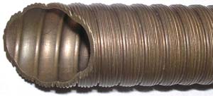

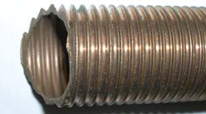

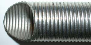

Enhanced Condenser Tubes
A special enhanced tube called a "corrugated tube" was used in the U.S. to re-tube existing utility steam condenser bundles at several Tennessee Valley Authority plants in the 1990s. The corrugated tube has a single helix configuration. The specific tubes tested are known as Korodense and were manufactured by Wolverine Tube (Figure 2a). This tube results in a 1.80 factor water-side heat transfer enhancement, 2.25 friction factor increase, and 30% steam side enhancement, relative to a smooth tube.

2. Enhanced condenser tube options.

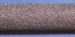

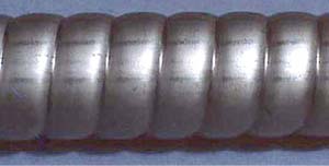

A number of horizontal integral-fin tubes have been developed for steam condensation. Some notable examples are (a) stainless steel Wolverine Korodense, (b) stainless steel Wieland NW-16, (c) copper-nickel Wieland 11-NW, (d) UOP attached particle tube, and (e) Yorkshire MERT (Multiply Enhanced Roped Tube). Courtesy: Dr. Ralph L. Webb

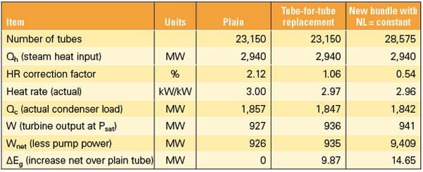

Calculation Procedure

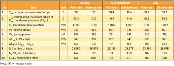

The following sections outline the step-by-step calculation procedure shown in Table 1 for calculating the potential plant efficiency and output that may be obtained from using enhanced turbines in this plant condenser.
Table 1. Comparison of enhanced vs. plain tube condenser (bundle replacement). Source: Dr. Ralph L. Webb
Turbine Output and Condenser Load. Using the heat rate correction factor found in Figure 1 at the plant rating condition, first calculate Qh = 2.942 * 946.3 = 2,784 MW. This heat input is assumed to be constant for the present calculations, where the plant is operating at different condenser saturation pressures (Psat). Calculating the heat rate (HR) at other values of Psat is easily performed using the heat rate correction factor (HRC) given in Figure 1.
Tsat is then found from the steam tables and added to line 2. The condenser heat rejection (Qc) is given by Qc = Qh – W, where W is the turbine output power (line 3 in Table 1). At the rated condition 76.2 mm Hg (3 in. Hg), Qc = 2,784 – 946.3 = 1,837.7 MW. At any known turbine backpressure, the HR = 2.942 * (1 + HRC/100). Using this HR with Qh = 2,784 MW, one may calculate the turbine output (W) and the condenser heat rejection (Qc = Qh – W) (line 4).
Objective Function and Constraints. The calculations are performed for two cases: a tube-for-tube replacement and a bundle replacement having Ne Le /Np Lp = 1 with fixed condenser flow rate where N = the number of condenser tubes, L = the length of the tubes, the subscript p represents the original plain or smooth tubes, and the subscript e represents the enhanced, replacement tubes. For both cases, the constraints are:

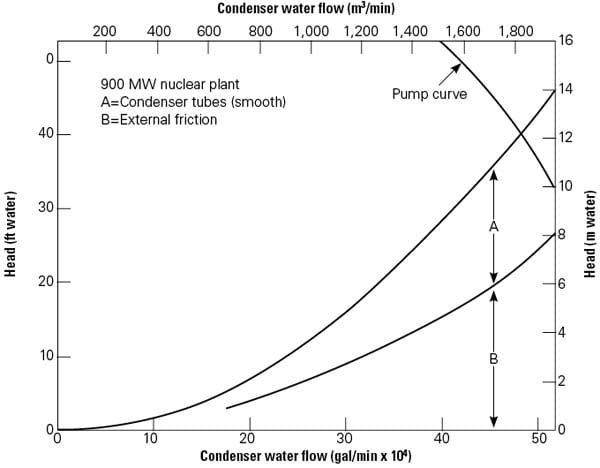

By replacing the plain tubes with enhanced tubes, the UA value of the condenser is increased, where A is the heat transfer area and U was defined previously as the overall heat transfer coefficient of the tubes. Because the enhanced tubes have a higher friction factor, and some have a smaller cross-sectional flow area, the balance point on the circulating water head versus flow curve (Figure 3) will occur at a reduced water flow rate for a tube-for-tube replacement.
3. System performance curves. The design pump and system head versus water flow rate for Arkansas Nuclear One, Unit 1 is illustrated. Note that the enhanced tubes have a higher friction factor (caused by a smaller diameter) that reduces the cooling water flow should like numbers of tubes be replaced. In this figure, the original design system friction balance point is off the right side of the figure, at about 600,000 gpm. With a tube-for-tube replacement, the condenser water flow will decrease to approximately 480,000 gpm. Therefore, to maintain like condenser pump system performance, additional enhanced tubes must be added to the condenser. Source: Gilbert Commonwealth Associates
Using the friction factor versus Reynolds number characteristic of a given enhanced tube, the total system friction head (pressure) versus flow characteristic was developed (Figure 3). The pump head versus flow characteristic was curve-fitted to a polynomial. Simultaneous solution of these two equations yielded the condenser water flow rate through the enhanced tube condenser. These figures show the system characteristic for the smooth tube condenser design and the friction head characteristic of system, less the head loss in the condenser tubes. Examination of the pump curves for the two plants shows that the percentage of the total head loss that occurs in the condenser tubes is 45%.

Increased Net Generation. Using the calculated values of W and Qc, the incremental generation rate ΔEg (MW) made possible by the enhanced tube geometries is determined using the calculated values of turbine output (W) and the pumping power (Wp). The new generation output is Wnet = W – Wp, assuming the main steam flow is held constant (line 6).
The net increased generation rate provided by the enhanced tube condenser (relative to the plain tube condenser) is ΔEg. The ΔEg = We – Wnet,p, where subscripts e and p refer to the enhanced and plain tube respectively (line 7).
Calculated Results
Calculations were performed for two cases: a tube-for-tube replacement with fixed pumping power and a bundle replacement having Ne Le /Np Lp = 1 with fixed condenser flow rate and pumping power, as discussed earlier.
Tube-for-Tube Replacement. The analysis showed that the tube-for-tube replacement will provide significantly lower ΔEg than the bundle replacement. This is because the tube-for-tube replacement results in a reduced condenser water flow rate. For the Figure 2b NW-16 tube, the flow rate reduction is 19%. This reduced flow rate causes the condenser to operate at higher thermal effectiveness, which degrades the condenser performance, relative to the second case, which holds water flow rate constant. For the NW-16 tube, the resulting annual average ΔEg is 9.87 MW.
Tube Bundle Replacement. In this case, the total length of all tubes in the enhanced tube condenser is the same as for the plain tube design. However, the design maintains the total water flow rate the same as for the plain tube design by using more tubes (of a shorter length) in the enhanced tube condenser. For the NW-16 tube design, the enhanced tube condenser has 23% more tubes than that in the plain tube condenser (lines 8, 9, 10).
Also remember that the condenser inlet water temperature changes for each month of the year. In this analysis, results were calculated for four representative months: January, April, July, and October. These results were then used to obtain the annual average values.
The calculated results are shown in Table 1 in the order of the calculation procedure just described. Calculated results are shown for January, April and October (combined because the cooling water inlet temperatures are the same), and July for both the plain and enhanced tube condenser designs. The key performance number shown in Table 1 is ΔEg, which is the increased net generation rate provided by the enhanced tube condenser design. The greatest ΔEg occurs in July at 36.8 MW. The smallest ΔEg occurs in January and is 3.2 MW. The reason the January ΔEg is so small is because the heat rate curve (Figure 1) is relatively flat at the low condensing pressure (Psat) of January. Hence, the warmer the condenser water inlet temperature, the greater the benefit of enhanced tubes.
Table 2 summarizes the annual average values of the performance parameters derived from Table 1 for the different seasons.
Table 2.    Annual average plant performance improvement for NW-16 tubes. Source: Dr. Ralph L. Webb

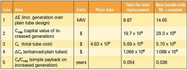

Economic Evaluation
The greatest economic benefit to the plant will occur if the entire tube bundle is replaced using the same total lineal tubing length as is used in the plain tube design (Table 2). However, the enhanced tube bundle will have about 25% more tubes and will provide the same condenser water flow rate as the plain tube design. The full potential of enhanced tubes can only be obtained with a new condenser bundle design. A tube-for-tube replacement results in reduced water flow rate, which diminishes the performance potential.
This evaluation assumes that the only cost affected is the cost of the tube bundle; the cost of the condenser shell is not included in the analysis. The capital benefits of the enhanced tube condenser are described by a simple payback analysis. This analysis calculates the simple payback based on:
  • The capital value of the increased generation rate, assuming a value of $2,000/kW (= 2 × 106 × ΔE).
  • The increased tube cost of the enhanced tube design, relative to the plain tube design given by
Table 3 shows the results of the payback analysis. Line 1 shows the increased generation capacity for the enhanced bundle design. The second line shows the capital value of the increased generation capacity (Ccap). Line 3 shows the total tube cost of the plain and enhanced tube bundles (Ct). The cost of plain and enhanced titanium tubes was based on data provided by Plymouth Tube, a manufacturer of titanium tubes. The present analysis is for 28.6-mm OD, 0.7-mm wall titanium tubes. It was also assumed that two-thirds of the tube cost is material and one-third is fabrication. The material costs were then adjusted by multiplying by the diameter ratio (28.6/25.4).
Table 3.    Summary of economic benefits of the NW-16 tube condenser. Source: Dr. Ralph L. Webb
Table 3 shows that the material content cost is $10.35/m (or $36.85/kg) at the time this analysis was completed in late 2009. The plain tube fabrication cost was assumed to remain constant. It is conservatively assumed that the fabrication cost of the enhanced tubes is 75% greater than for the plain tubes. This resulted in tube costs of $14.93/m and $18.37/m for the plain and enhanced tubes, respectively.
Using the values given above, the tube bundle cost increment for the enhanced condenser tubes, relative to plain tube design (ΔCt), is
This value is shown on Line 4 of Table 3.
The simple payback on the increased generation cost for the tube-for-tube replacement is 0.036 years and 0.024 years for the "new bundle" — or just a matter of weeks (line 5). Note that the ΔE value in Table 3 is the net increase in turbine generator power over the plain tube design with the condenser water pumping power charged to the plain tube condenser. This is because the enhanced tube condenser has the same condenser water pumping power as the plain tube design. A tube-for-tube replacement will provide only 67% of the economic benefits (Ccap) of the entire tube bundle replacement.

A similar analysis was also performed for the Wolverine Korodense tube (Figure 2a). It is interesting to compare the performance and economics of the Korodense tube condenser with that of the NW-16 tube condenser. Comparison with the NW-16 tube condenser is done for the same number of tubes (28,575) and tube length shown for the "new bundle" with Ne Le = constant, as shown in Tables 2 and 3. The Korodense tube has 20% and 40% higher tube side heat transfer coefficient and friction, respectively, than the NW-16 tube (at the same Reynolds number). However, the steam side enhancement is 25% smaller than provided by the NW-16 tube.
The analysis shows that the Korodense tube results in a lower water flow rate for the same pumping power as the NW-16 and plain tubes. This flow rate reduction reduces the thermal performance. For a Korodense tube condenser with 28,575 tubes, the water flow rate is reduced 8%, relative to the NW-16 and plain tube condensers. The annual average value of ΔE is 24% below that of the NW-16 tube condenser, and the simple payback is 0.048 years. For the tube-for-tube replacement case, the annual average value of ΔE is 53% below that of the NW-16 tube condenser, and the simple payback is 0.12 years.
