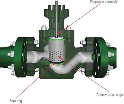

Trim sets can be designed to enable a valve to perform and survive under harsh conditions, including cavitation, flashing, and particulate matter in the flow stream. The first two conditions can be attributed to the large pressure change across the valve and can be controlled by a well-designed trim package. The trim set we were asked to evaluate, which was intended as a replacement for an original Fisher product, consisted of three parts: a plug/stem assembly, seat ring, and cage (Figure 6).
6.    Similar but different. Fisher evaluated the trim set provided by a company that replicates OEM hardware. A trim set consists of three parts: a plug/stem assembly, seat ring, and cage. The replacement parts appeared to be identical to the eye but performed quite differently in laboratory testing. Source: Fisher Division, Emerson Process Management
The seat ring and plug/stem assembly were actually OEM parts that had been reworked for reuse and appeared to be in good condition. A careful examination found the critical dimensions to be within tolerance. Using these parts should not be a cause for concern.
The same could not be said for the all-important cage, which was manufactured by the replicator in an attempt to copy the Fisher Cavitrol III cage with three stages. Three-stage Cavitrol III trims can eliminate cavitation noise and damage in a valve when properly applied. This trim is normally used where pressure drop is up to 149 bar (~2,100 psig) for two-stage and 207 bar (~3,000 psig) for three-stage trim. Liquid passes through cage orifices in each stage, undergoing a portion of the total required pressure drop. This partial pressure drop in each stage of a properly sized and carefully manufactured valve trim is intended to prevent the liquid pressure from falling to, or below, its vapor pressure, eliminating the formation of vapor bubbles.
As it turned out, the cage sent for testing had a number of significant flaws and was potentially dangerous. These flaws could lead to performance and operational issues, which could lead to unexpected outages and lost revenue.
Dimensional flaws. It was obvious on first inspection of the cage that the replicator did not make one hole on the outer diameter even though it exists on the inner diameter (ID). Hole sizing on the ID was found to be incorrect when checked against the original drawing for that part. The replicator’s cage had only ~40% of the holes correct.
Holes in the cage also did not follow the correct geometry as per the drawing. In some cases, the largest holes were too close together, leaving almost no material between them. Nor did the holes follow the drawing, indicating a very careless transition between hole sizes. The other dimensions were within tolerance.
According to valve engineers with years of experience designing trim sets for high-pressure valves, these manufacturing inconsistencies could lower the flow capacity of the valve. In addition, cavitation protection may be compromised.
Hardness. There are sound engineering reasons for specifying a certain level of cage hardness to withstand erosion caused by friction within a valve body and by particulate matter in the process fluid. Also, closely fitting trim parts must have the same coefficient of thermal expansion so they can expand and contract at similar rates. If the materials are not compatible, the parts could seize up when heated to temperatures as high as 300F to 400F, or it may be impossible to achieve complete valve shutoff.
The material of the cage tested was found to match the specification, but the hardness varied greatly around the diameter of the cage, from 12 HRC to 35 HRC. Any hardness level below 31 HRC is unacceptable for service where cavitation is a possibility.
The most common explanation for variations in material hardness is that too many parts were placed in the heat-treat oven at the same time and some parts may have been touching each other. However, the wide variations in this particular cage led us to believe that it was never heat treated. Specifications for the heat treatment require particular temperatures and times at which parts are to be held. There is very little room for deviation from the designated method when trying to achieve a specific hardness. If this part had been given the proper treatment, there would have been little to no variation in material hardness. Of course, skipping heat treatment altogether enabled the parts replicator to keep prices low — with quality to match.

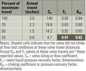

Flow through the valve will not increase with a further decrease in downstream pressure or increase in upstream pressure, thus it is "choked." Data from testing of the replicator trim set in Emerson’s R.A. Engel Flow Lab (see table) show choking conditions when the valve is open about 50% or more. A valve that is experiencing choking cavitation is operating at the most severe level of cavitation, which is not recommended, unless the valve trim is engineered for that purpose.
Valve copy fails test. Flow coefficients for an ANSI Class 1500, 4-inch Fisher with Cavitrol III-3 stage trim are compared to a non-OEM valve. Source: Fisher Division, Emerson Process Management
The data begin to diverge at valve openings of ~50% (Figure 7). More staging will cause the capacity at these points to be lower than the OEM design data, but if there is less staging, the capacity is allowed to rise, as in the replicator trim. The concern with these lines diverging is the potential for loss of cavitation protection. Because the cage material is not uniformly hard, it can be eroded away more rapidly if cavitation protection is lost.
7.    Replicant fails lab tests. The laboratory test data show that flow through the valve begins to diverge at about 50% valve opening. When these lines diverge above 50%, the flow rate through the valve rises, as does the potential for cavitation damage. The laboratory testing also showed that the cage material is not uniformly hard, further increasing the potential for damage caused by cavitation in the valve. Source: Fisher Division, Emerson Process Management
