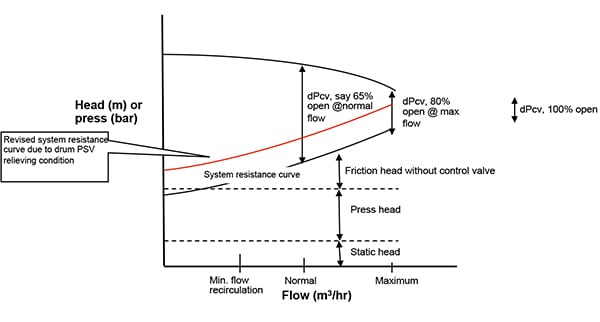

Note that the difference between the boiler feed pump head-flow curve and the system resistance curve (Figure 1) provides the basis for the pressure drop available for the drum level control valve. During startup and low-load operation, when drum pressures are low, the valve may experience severe service due to high pressure drop. These conditions could lead to valve cavitation and subsequent destruction of the valve trim along with pipe hammer, which could lead to piping and piping support damage. It is, therefore, essential that the sizing and design of the drum level control valve be such that these problems are avoided. For this purpose, the entire range of service conditions should be provided on the valve data sheet, as this will enable the valve supplier to make the correct valve/trim selection.
PWR_020114_IC_FWCV_figure1
1. Establishing drum level control valve pressure drop. Courtesy: Bechtel Power Corp.

These design conditions and the control valve pressure drop variation can be well represented on a graph similar to the generic one shown in Figure 1, which includes the boiler feed pump (constant speed) head-flow curve, system resistance curve, and the control valve pressure drop (dPcv).
As flow increases, the available pressure drop across the control valve decreases. As a result, the control valve opening increases. The increase in control valve opening is, however, restricted to around 80% to 85% (due to controllability considerations), and the corresponding Cv establishes the maximum flow capability of the control valve.
Figure 1 also shows that as the pressure head increases due to high drum pressure (highest set pressure of pressure safety valve plus 3%), the system resistance line moves upward and cuts back on the available pressure drop across the control valve. At this point, the control valve opening increases, reducing the valve dP to compensate for the increase in pressure head.
The result is that the operating point moves to the left side of the head-flow curve. At this point, it is important that the control valve opening remains within its operating range; otherwise, the drum level may not be controllable. It is also critical that this operating point falls on the right hand side of the minimum recirculation flow line; otherwise, the entire flow through the feedwater pump will go toward recirculation, and no flow will reach the drum.
