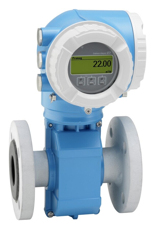

Overcome Spatial Constraints with 0xDN Flow Measurement
Flow monitoring is critical for maintaining efficient thermal transfer and water usage effectiveness (WUE), which is the ratio of cooling water used to total energy consumed by IT equipment. However, most flowmeters traditionally deployed in liquid cooling environments require significant lengths of straight pipe upstream and downstream—often five to 10 pipe diameters—of the sensor to condition the fluid and ensure a uniform flow profile for accurate measurement. In the dense and space-constrained architectures of modern data centers, providing these straight runs is inconvenient and often impractical.
To overcome this limitation, leading suppliers offer advanced full-bore electromagnetic flowmeters with 0xDN (zero diameter) capabilities, meaning no installation restrictions up or downstream of the flowmeter. This is made possible with advanced measuring tube designs, multiple electrodes in the sensor, and sophisticated signal processing algorithms, enabling 0xDN technology to provide precise flow measurements regardless of flow profile distortion (Figure 2).
electromagnetic-flowmeters
2. Leading electromagnetic flowmeters, such as the Endress+Hauser Proline Promag W 300, incorporate 0xDN technology to provide accurate measurement, without the restrictive straight-pipe run requirements that historically impeded installation in tight server spaces. Courtesy: Endress+Hauser
This significantly increases process flexibility, allowing installation immediately downstream of a 90-degree elbow, a pump, or a control valve. It also empowers mechanical designers to further reduce the footprint of cooling skids without sacrificing measurement integrity, providing more space dedicated to the high-value IT components that drive profitability.

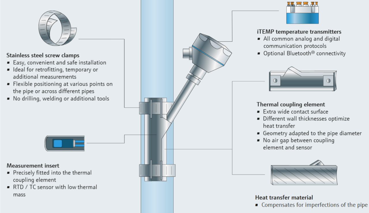

Simplify Installation and Increase Flexibility with Non-Invasive Temperature Measurement
Temperature measurement is the other bedrock of reliable cooling, providing monitoring nodes around the entire process network. Traditionally, precise temperature measurement required installing thermowells directly into process pipes, and while effective, invasive thermowells create flow disturbances, which force pumps to work harder and consume more energy to overcome pressure drops. Furthermore, every pipe penetration introduces a potential leak or contamination point, and thermowells cannot be tapped into live process streams, so downtime is required.
However, material science advancements have yielded highly accurate non-invasive surface temperature sensors. While most clamp-on temperature instruments require electronic compensation—adding processing time and slowing down the measurement substantially—to adjust the measured value due to ambient effects, today’s leading surface options have addressed this challenge using insulation only. With a mechanical clamp-on design and advanced thermal coupling elements, these modern devices measure heat directly through the pipe wall without requiring electronic compensation (Figure 3).
non-invasive-temperature-sensor
3. The Endress+Hauser SurfaceLine TM611 clamp-on non-invasive temperature sensor installed in a thermal coupling element provides precise thermal measurement without the need for invasive thermowells, eliminating leak risks, preventing pressure drops in the pipeline, and facilitating seamless retrofits for additional measuring points without shutting down the process. Courtesy: Endress+Hauser
This provides response times and accuracy comparable to invasive installations, while eliminating the need for pipe penetration, which reduces pressure loss, speeds up installation during rapid facility scaleups, and simplifies the decision to add measurement nodes when the need arises.

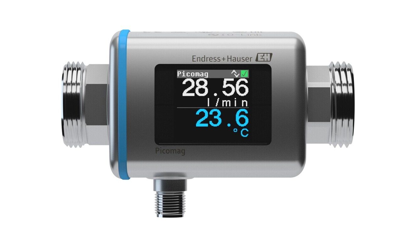

Secure the Digital Backbone
Modern innovation requires a delicate balance between digital capabilities and cybersecurity considerations. While wireless communication technologies like Bluetooth offer convenience for commissioning, maintenance, and monitoring in many industrial sectors, many data center cybersecurity policies require wireless-deactivated devices in IT white spaces. To support these sometimes-conflicting requirements, leading instrumentation suppliers provide dedicated data center/original equipment manufacturer (OEM)-configured compact devices specially designed for process measurements in server halls, without compromising on measurement or instrument diagnostic capabilities (Figure 4).
Picomag-flow-temperature-conductivity-measurement
4. The Endress+Hauser Picomag data center/OEM variant provides accurate flow, temperature, and conductivity measurements in a highly compact design, and it is manufactured with wireless communications deactivated to ensure security in sensitive IT white spaces. Courtesy: Endress+Hauser
These variants are delivered from the factory with wireless connectivity deactivated at the hardware level, while offering reliable hardwired protocols for transmitting information, such as IO-Link or standard analog signals (4–20 mA). This provides data center facility operators and OEMs with secure, plug-and-play components that align with zero-trust wireless policies, while still delivering continuous flow, temperature, and conductivity data from a single compact node, tailormade for measuring process conditions in server room secondary cooling loops.
