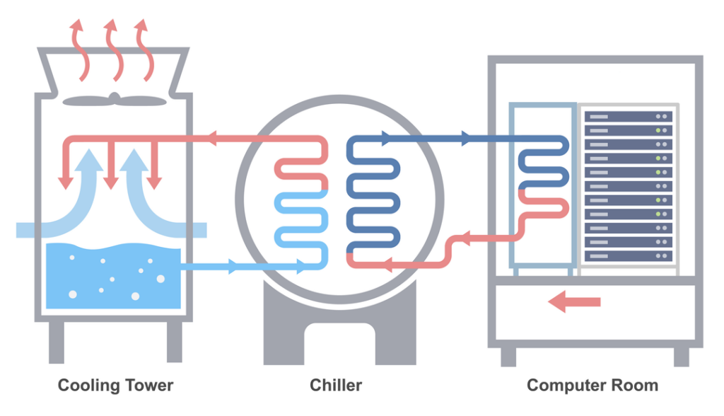

These factors influenced the development of liquid cooling in data centers as a more efficient method for heat transfer. This approach uses a liquid medium—typically purified or treated water—which has a significantly higher specific heat capacity than air. Heat generated by high-density computing components is absorbed into the liquid and circulated through a loop within the white space of the data center. This warmed liquid is then transferred to a primary chiller loop that serves as the facility-level cooling backbone (Figure 1).
1. Liquid cooling in data centers encompasses circulation of a liquid medium, typically in two loops, to transfer heat away from data center infrastructure and keep it cool. Courtesy: Endress+Hauser
The primary loop includes large industrial chillers and heat exchangers that transfer heat to the external environment, enabling a continuous cycle of thermal regulation. This dual-loop design isolates sensitive IT environments from facility-level fluctuations while maximizing thermal efficiency and operational control.

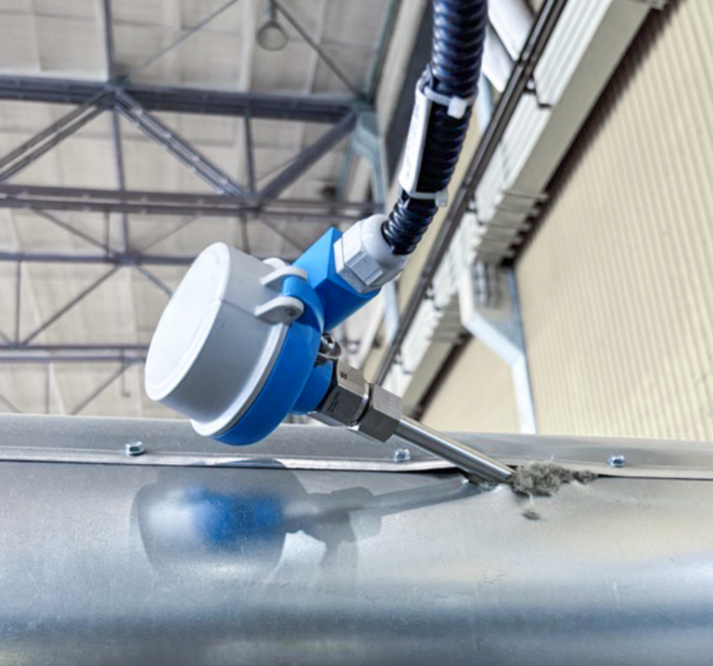

Accurate instrumentation is directly linked to energy efficiency. For example, high-accuracy temperature sensors allow data center operators to run cooling systems closer to their optimal thermal setpoints (Figure 2). A smaller error band means less over-cooling is required to create a safety buffer, which reduces pump and chiller workloads and, consequently, lowers energy consumption. Water is a more expensive utility than air, so optimizing energy efficiency is even more critical for liquid cooling than for air cooling systems.
2. An Endress+Hauser iTHERM SurfaceLine TM611 non-invasive thermometer insulated in a cooling loop application. Courtesy: Endress+Hauser

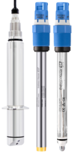

Furthermore, liquid analysis sensors are used to monitor water properties like turbidity, conductivity, and pH, which serve as proxies to verify effective water polishing and treatment operations (Figure 4). Operators use this information to ensure coolant remains free of contaminants that could cause corrosion or fouling.
4. Liquid analysis instruments, such as the Endress+Hauser Turbimax CUS52D turbidity sensor (left), Memosens CLS82E conductivity probe (center), and Memosens CPS11E digital pH sensor (right), are used to measure various properties of water or other process media to ensure coolants maintain purity for the greatest efficiency in liquid cooling loops. Courtesy: Endress+Hauser

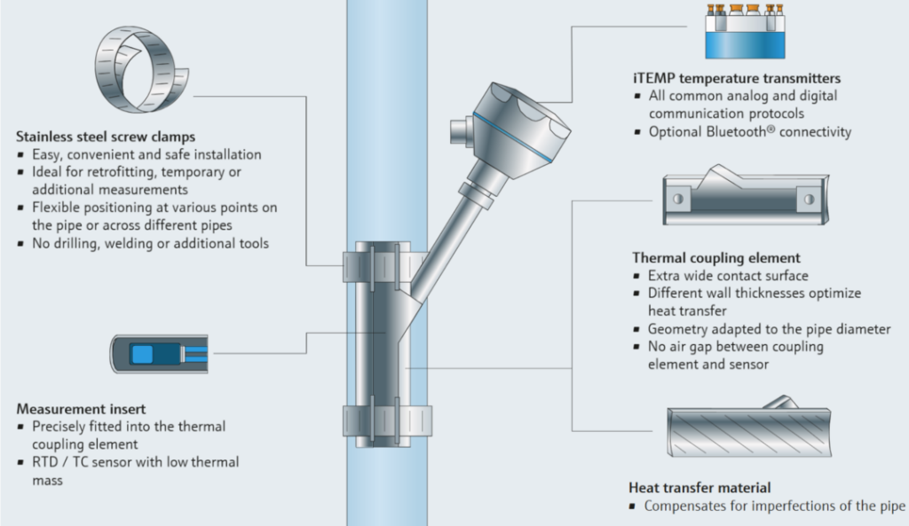

Use Case: A Non-Invasive Approach to Temperature Measurement
As data centers scale, the need for instrumentation deployment simplicity also grows to support increased production demands without introducing unnecessary risks. Many liquid cooling systems still use traditional thermometers installed in thermowells that penetrate process pipes. While effective, thermowells create flow disturbances that increase pump energy consumption and introduce potential leak points that risk contaminating high-purity liquid coolant. The Endress+Hauser TM611 eliminates these concerns with a mechanical clamp-on design, providing a direct and thermally conductive connection to the pipe, for comparable accuracy and response times to traditional invasive thermometers without the risks associated with pipe penetration (Figure 5).
5. The Endress+Hauser iTHERM SurfaceLine TM611 temperature sensor provides accurate and precise measurement, along with simple installation without the need for invasive thermowells. These benefits enable hyperscalers to run cooling systems closer to optimal thermal setpoints while reducing pump and chiller workloads and lowering energy consumption. Courtesy: Endress+Hauser
This removes the need to index insertion depths or perform pipe intrusion resonance calculations, accelerating front-end design. Because this method utilizes material science and mechanical design to measure heat directly in the line, it is much more accurate than conventional non-invasive temperature instruments, with measurements that are often degraded by ambient surroundings (Figure 6).

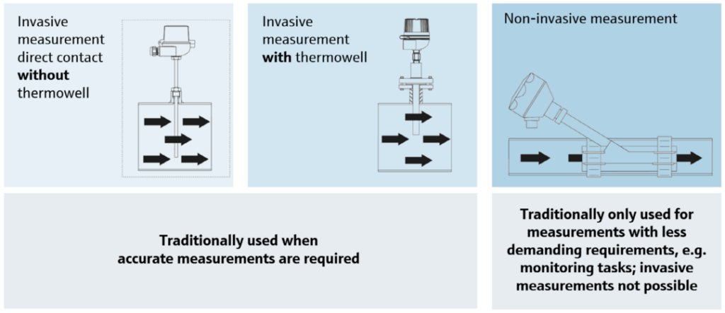

6. Traditionally, invasive thermowells—which create flow disturbances, increase pump energy consumption, and introduce potential leak points that risk contaminating high-purity liquid coolant—were required in high-precision applications. However, leading non-invasive temperature sensors eliminate these concerns with direct and thermally conductive connections to pipes, providing comparable accuracy and response times to conventional invasive installations without the risks associated with pipe penetration. Courtesy: Endress+Hauser
This non-invasive technology is ideal for data center cooling loops where cleanliness and installation simplicity are critical. The absence of a thermowell eliminates the need for drilling and welding, while also alleviating additional energy-wasting pressure drops in the system for pumps to overcome. For hyperscalers deploying and upgrading systems at an aggressive pace, these types of installations provide a simple mechanical design, with reliable, low-maintenance, and efficient solutions to ensure uptime and performance in high-stakes deployments.
