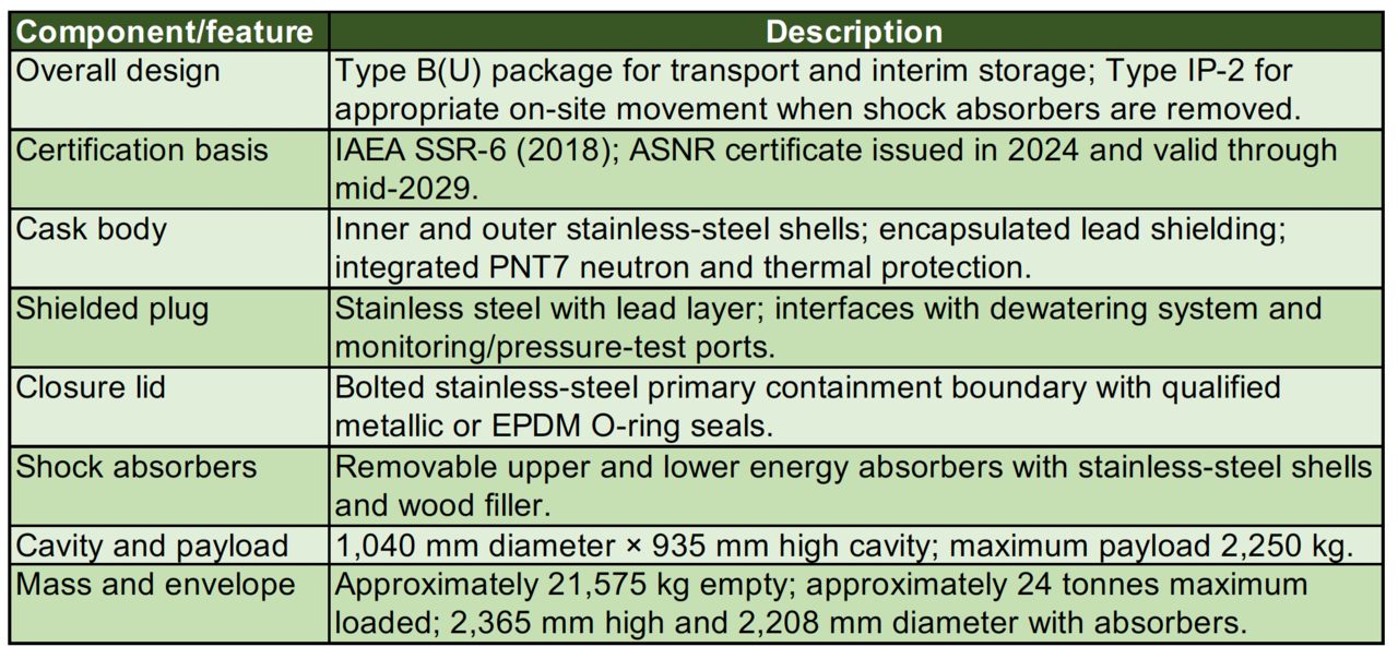

The R86 is built around a passive safety philosophy. Shielding, thermal protection, and containment are provided by fixed materials and engineered geometry, without relying on active cooling, powered ventilation, or forced circulation. The package is organized around four principal subassemblies: the cask body, shielded plug, closure lid, and upper and lower shock absorbers (Figure 1).
1. R86 Type B(U) package showing the cask body, shielded plug, closure lid, and upper and lower shock absorbers. Courtesy: Robatel Technologies
At the center of the design is a cylindrical cask body formed by inner and outer stainless-steel shells surrounding the shielding system. Lead provides the principal gamma shielding, while a 30-millimeter (mm) layer of Robatel’s PNT7 compound provides neutron moderation, thermal insulation, and fire resistance. A removable shielded plug closes the cavity and adds further lead shielding. Above it, a bolted stainless-steel lid forms the primary containment boundary, using qualified metallic or EPDM (ethylene propylene diene monomer) O-ring seals with provisions for leak testing.
For off-site Type B(U) transport—a regulatory designation meaning the package is approved by its country of origin to safely carry highly radioactive waste over public routes—removable shock absorbers at the top and bottom of the package provide mechanical protection under accident conditions. Each uses a stainless-steel shell filled with energy-absorbing wood to manage severe impact loads. With the absorbers installed, the R86 is approximately 2,365 mm high and 2,208 mm in diameter, with an internal cavity measuring 1,040 mm in diameter and 935 mm in height. The package can accommodate a maximum payload of 2,250 kilograms (kg), with a maximum loaded mass of approximately 24 tonnes. The result is a compact package in which containment, shielding, thermal performance, and impact protection are integrated into the basic architecture (Table 1) rather than added through active systems.
Table 1. Principal R86 specifications and architecture. Source: Robatel Technologies

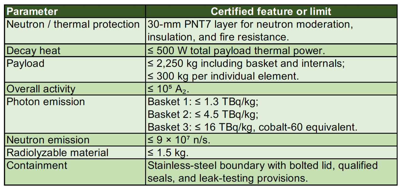

That passive-safety philosophy carries through the R86’s shielding, thermal management, and containment systems. Rather than relying on active or replaceable components, these functions are built directly into the package body. Encapsulating the lead within stainless steel protects the shielding material while providing durable, cleanable, and corrosion-resistant external surfaces.
The 30-mm PNT7 layer complements the lead by performing several functions at once: moderating neutrons, providing thermal insulation, and maintaining protection under the regulatory fire environment. Thermal management is similarly passive, with allowable payload decay heat limited to 500 watts (W) and no requirement for powered cooling, ventilation, or forced circulation.
Containment is provided by the stainless-steel body, shielded plug, bolted closure lid, and qualified sealing system. Metallic or EPDM O-ring seals, together with dedicated pressure-test interfaces, allow operators to verify leak-tightness after closure without disturbing the protected contents. Taken together, the shielding, thermal, and containment systems illustrate the basic design logic of the R86: safety functions are embedded in the package itself and remain available without dependence on active equipment.
One Package, Three Ways to Match the Waste

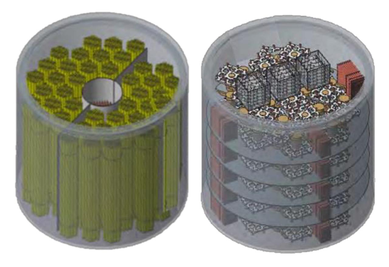

If passive safety defines the R86’s outer architecture, adaptability defines what happens inside it. The package is designed around three interchangeable basket configurations that allow operators to match the internal arrangement to the radiation profile and geometry of the waste while remaining within a common certified package envelope.
The Robatel R86 can accept up to 2,250 kg in its cavity, including the basket and internal hardware, with individual elements limited to 300 kg. Total decay heat is limited to 500 W, total activity to 105 A2—a baseline safety value used to measure radioactive risk—neutron emissions tp 9 x 107 neutrons per second (n/s), and radiolyzable material to 1.5 kg. Within those limits, the three baskets provide progressively higher photon-emission capability: approximately 1.3 terabecquerels per kilogram (TBq/kg) of cobalt-60 equivalent for basket 1, 4.5 TBq/kg for basket 2, and 16 TBq/kg for basket 3.
The importance of that flexibility (Table 2) becomes clear when dealing with activated metallic waste, which is rarely uniform. A single campaign may involve rods, clustered components, short segments, and cut portions of reactor internals, each with different geometries and source terms. Instead of forcing all of that material into one conservative internal configuration, operators can select a pre-engineered basket better suited to the actual payload.
Table 2. Shielding, thermal, containment, and content limits. Source: Robatel Technologies
That can reduce the need for custom internal structures, campaign-specific engineering, and additional segmentation before loading. The certified outer package remains the same; what changes is the internal arrangement used to accommodate the waste. In practical terms, the R86 combines the repeatability of a standardized transport package with the flexibility needed for very different waste streams (Figure 2).
2. Alternative basket arrangements: on the left is a concept arrangement for bars and tubes, while on the right is a concept arrangement for the cluster guide and fuel rod portions. Courtesy: Robatel Technologies

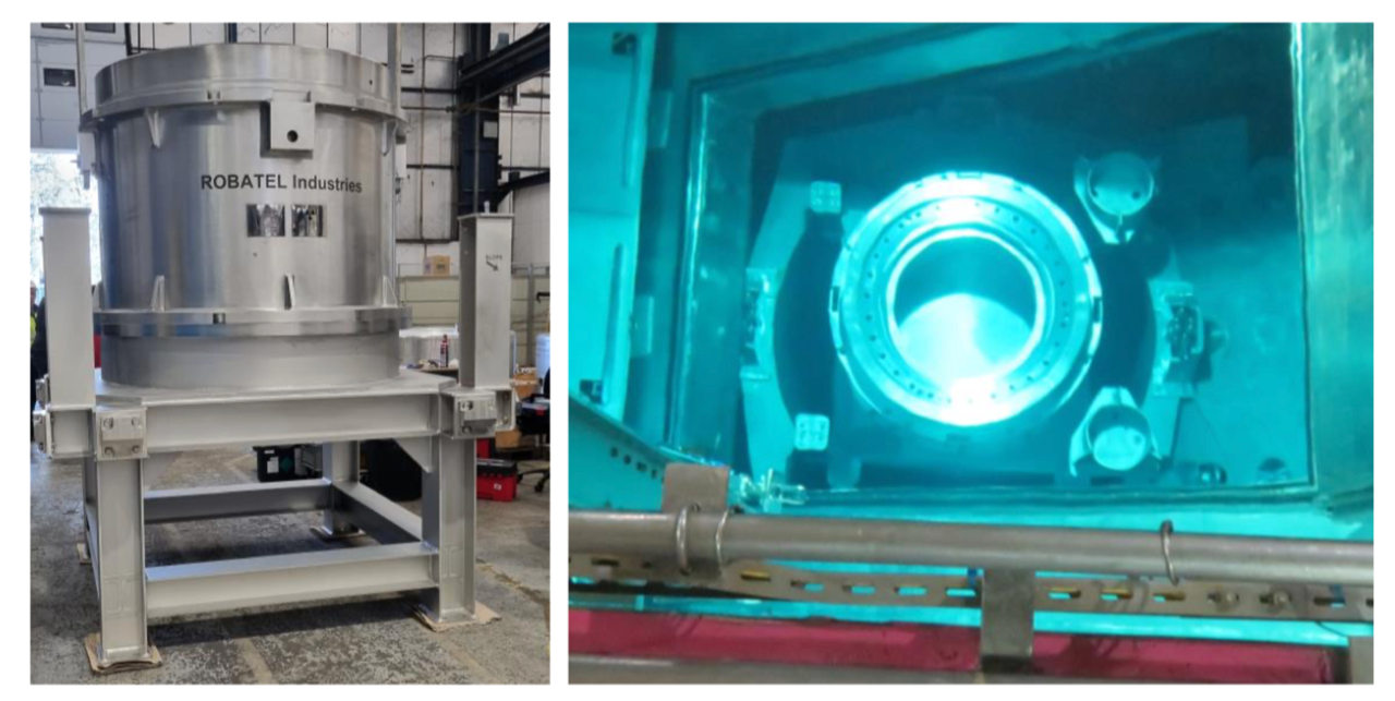

In 2024, the first production units entered commercial service at ENGIE Electrabel’s Doel and Tihange nuclear plants in Belgium (Figure 3), in partnership with Westinghouse. The R86 handled thimble plug assemblies, poison rod assemblies, reactor control cluster assemblies, rod segments, and cut portions of vessel internals. The units were incorporated into existing procedures for packaging, on-site movement, interim buffering, and road transport using plant pools, cranes, and transport frames already in service.
3. The R86 was delivered to ENGIE Electrabel for the transport and long-term storage of activated/contaminated solid elements that must be disposed of after dismantling. Courtesy: Robatel Technologies
The CW configuration provided redundant lifting points and allowed higher-dose components to be loaded underwater. After loading, the integrated dewatering system removed water from the package, and a pressure-rise dry test verified the transition to a controlled dry condition and supported radiolysis control. This demonstrated that the R86 could be introduced into established plant workflows without requiring an entirely new handling system (Figure 4).
4. R86CW positioned on a platform in the pool before loading, illustrating integration with underwater handling and dewatering operations. Courtesy: Robatel Technologies

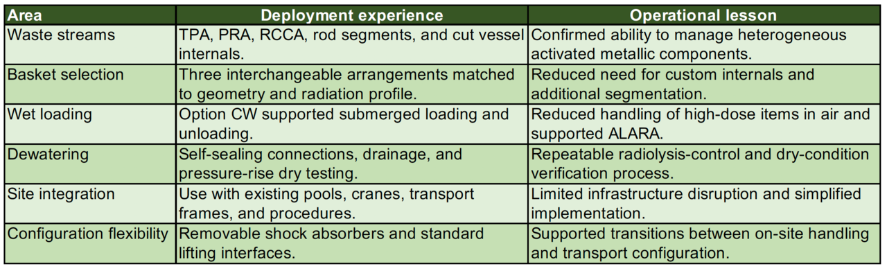

The deployment also confirmed the practical value of the interchangeable basket system. Basket configurations could be matched to component geometry and gamma-emission levels, reducing the need for custom internals and additional segmentation. Limiting unnecessary cutting can reduce occupational exposure, secondary waste, contamination-control requirements, and preparation time. The deployment also showed that interchangeable baskets can reduce engineering burden and that the dewatering and pressure-rise dry-test sequence can be performed repeatably in pool-side operations.
The Doel and Tihange experience connected the R86’s certified design with actual plant operations (Table 3). The package was manufactured, delivered, loaded, handled, dewatered, and moved with representative activated metallic waste. The result is a certified, passively safe, and adaptable system whose principal design and operating features have now been demonstrated in a nuclear facility.
Table 3. Doel and Tihange deployment: operating functions and lessons. Source: Robatel Technologies
