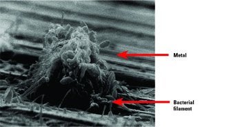

  • Microbiological fouling by bacteria naturally occurring in water. As the bacteria attach to the base metal of tube surfaces (Figure 2), they form a thin film of slime that grows and traps other particulates, further reducing heat transfer.
    2.	Hungry critters. Bacterial attack of tubes' base metal is a problem that can be just as serious as nonbacterial pitting or deposition. Courtesy: Conco Systems Inc.
