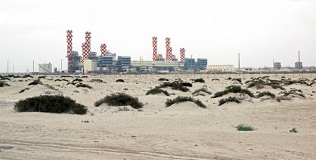

Like any expanding economy, Bahrain's requires increasing amounts of reliable and affordable power. To get it, the kingdom decided three years ago to open up its electricity sector to outside investors. The $500 million, 950-MW Al Ezzel Power Plant (Figure 1) was developed by the Ministry of Finance and National Economy as Bahrain's first independent generating station. Located in the Hidd industrial area of Muharraq Island, just south of Bahrain International Airport, the plant burns natural gas supplied by Bahrain Petroleum Co. under a long-term contract.
1. Taking care of business. Phase 1 of the Al Ezzel Power Plant project began commercial operation in April 2006 by putting 470 MW of clean, natural gas–fired capacity on Bahrain's national grid. Phase II added another 480 MW in May of this year. Courtesy: Siemens Power Generation
