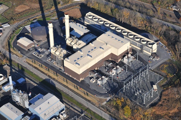

The Empire Generating Plant in Rensselaer, N.Y., just outside Albany, is a 535-MW plant with a 635-MW peaking capacity. The natural gas–fired combined cycle facility began operations in September 2010 and employs two GE 7FA combustion turbines, two Alstom three-pressure heat recovery steam generators (HRSGs), and one GE D-11 reheat steam turbine.
Though it’s situated right on the Hudson River, it uses no river water in its operations. Instead, the plant uses non-disinfected municipal secondary effluent as its only process water supply, allowing the facility to conserve freshwater consumption by as much as 4,800 gallons per minute during the summer high-demand period.

Rather than drawing water from the Hudson—which would have been simpler and cheaper but would likely have intensified opposition from residents and environmental groups, not to mention potentially running afoul of future Environmental Protection Agency regulations—Empire decided to make use of the non-disinfected secondary effluent from the Albany County Sewer District waste treatment plant just across the river. CH2M HILL built a 28-inch graywater pipeline under the Hudson to the plant.
In addition to requiring CH2M HILL to bore a tunnel under the river, this idea also broke ground when it came to health and environmental standards, because there were no applicable state regulations governing the use of secondary effluent for cooling towers. Looking for guidance, the project managers decide to adopt California’s Title 22 tertiary disinfected water quality requirements as a best practice to control potential pathogen vectors from cooling tower drift. This meant employing a combination of treatment processes, including chloramination, coagulation, upflow sand filtration, hypochlorination, and chlorine contact.
In addition to supplying cooling tower water, the municipal secondary effluent is used as the makeup source for service water and demineralized water supplies. The service water is used for evaporative cooler supplies, demineralized water treatment, and miscellaneous process use. Service water is produced by intercepting the upflow sand-filtered effluent and processing it through ultrafiltration, followed by monochloramine addition. Using monochloramine as a disinfectant minimizes the formation of trihalomethane compounds that cannot be removed by the demineralized water treatment process. The filtered service water is then forwarded to the reverse osmosis and mixed bed ion exchange units to produce demineralized water for the HRSGs.
