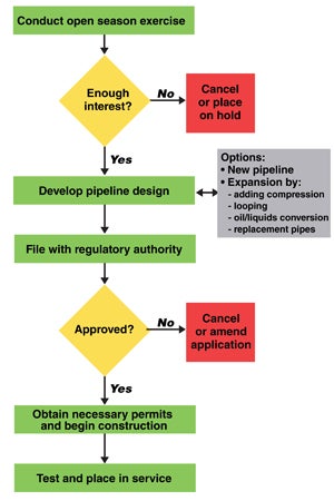

1. Getting to the construction stage of a pipeline project involves a long series of careful decision-making. Source: EIA
Most projects are initiated by pipeline developers based on analysis of the changes in the macro environment and understanding current and future bottlenecks based on anticipated gas flows and through regular discussions with prospective shippers. In most cases expansion of existing pipeline systems is the preferred method because it is efficient and more economic than greenfield construction. But this is not always the case. The developer will analyze rough project scopes, costs, and rates to test the general feasibility of the project with prospective shippers. This is sometimes done with minimal fieldwork using desktop surveying of possible routes. Assuming this clears the sniff test with the market, more in-depth work will be done before it is considered a project that can go public. This could take a number of months.
