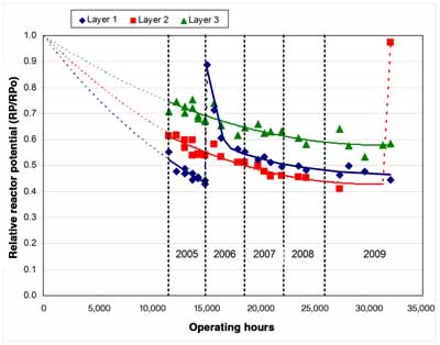

The results of the past five years of testing are shown in Figure 2, as a function of RP/RPo, where RP is the current measurement of RP and RPo is the value for the initial fresh, unexposed catalyst layer when the SCR started up in 2002. The RP/RPo results for the individual layers clearly reflect the effect of catalyst layer replacements (Layer 1 before the 2006 ozone season and Layer 2 during 2009) and also illustrate the deterioration of catalyst performance that occurs over time.
2. This graph shows the KnoxCheck reactor potential test results for the period of 2005 to 2009. RPo represents the reactor potential of the individual layers when freshly installed. Courtesy: Fossil Energy Research Corp.
The replacement of Layer 1 with new catalyst prior to the 2006 ozone season provided an opportunity to quantitatively compare the results of the in situ KnoxCheck measurements to both the activity provided by the catalyst vendor and an activity value provided by a third-party catalyst testing laboratory that tested an unused sample of catalyst. The results of this comparison testing showed a good agreement of the in situ KnoxCheck activity measurements to the vendor’s value of activity, as well as the third-party laboratory’s measurements. The KnoxCheck measurements were 6% higher than the value from the vendor, while the third-party laboratory’s value was 3% lower than the vendor’s reported activity.
