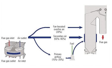

Ideal pulverized coal combustion occurs when a coal particle is burned completely and all of the carbon is converted to CO2, all H2 is converted to H2O, and all sulfur is converted to SO2. Deviations from ideal combustion are indicated by higher-than-desired carbon in ash, secondary combustion at the superheater, and objectionable CO levels in the flue gas. Most large utility boilers were originally designed to operate with 15% to 20% excess air (Figure 1) to make up for air and fuel imbalances in the burner belt. Critical tolerances for the combustion airflow paths to the boiler are noted in Figure 2.
1. Different paths. Air commonly takes three different paths, but it all ends up in the furnace—whether you want it there or not. The key to achieving excellent combustion efficiency is properly managing the amount of air supply and plugging the leaks. Source: Storm Technologies

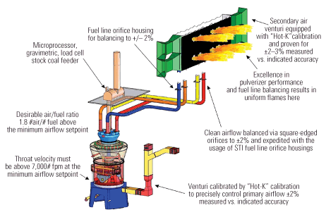

2. Short course. These are the key design and operating measures for combustion air, from the pulverizer to the furnace, for a typical 500-MW coal-fired plant. Source: Storm Technologies

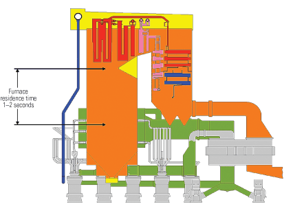

Within most utility furnaces, the residence time for coal particles to completely burn out is only between 1 and 2 seconds (Figure 3). Boilers designed in the 1970s had pre-low-NOx burners, and the short furnace residence time was compensated for by intense and turbulent mixing, with a very high flame temperature. The intensity of burner belt combustion, with the resultant high NOx production, is unacceptable today. Today's typical low-NOx burners have evolved into systems that inject combustion air into two, three, or four air zones at the burners (secondary air). For further reduction, most low-NOx firing systems utilize multiple levels of combustion airflow for staged combustion. A best practice is to ensure that combustion is completed in the furnace with a stoichiometry of 1.15 to 1.20 (excess air of 15% to 20%) before the products of combustion reach the superheater.
3. Burning desire. Best practices dictate staged combustion with multiple air zones in the furnace to manage NOx production. Many boilers have relatively short furnace boxes with residence times below the desired 1 to 2 seconds. Source: Storm Technologies

Primary airflow in a PC-fired boiler is akin to the gas valve of a gas-fired boiler. Achieving rapid response of pulverized coal to the furnace requires accurate and responsive changes in the transport or primary airflow. In-furnace NOx reduction by staged combustion or "lean burn" is possible by using measured and controlled overfire airflows. This can be effective when pulverizers are optimized for the best fineness and distribution as a complement to the optimum proportioning of total air and fuel delivered to the furnace.
