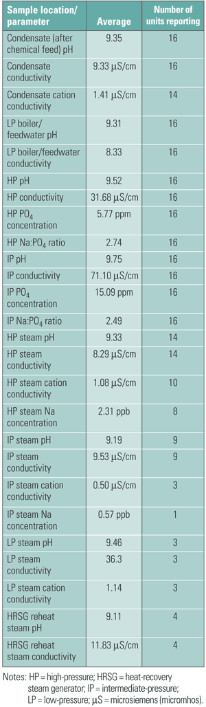

Operator testing does have a role in monitoring, but it should not be the first line of defense in problem detection. Wet testing can find a problem, but only if it exists when the sample is taken. The rest of the time, the plant is "flying blind." For most plants, the averages appeared to be within target ranges (see table), but variability was extreme, and many target ranges didn't provide optimal equipment protection.
graphSource: Dan Sampson
Typical chemistry of treatment programs "before"
