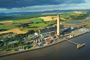

The prototype, developed by Norwegian firm Aker Clean Carbon, is an exact, 1-MW replica of the full-scale carbon capture plant (Figure 6). It will use Aker Clean Carbon’s postcombustion capture process, which employs an amine solvent to remove carbon dioxide from flue gas. If successful, ScottishPower could use the technology to scale up the prototype and deliver a full CCS demonstration project by 2014 — a timescale that aligns perfectly with the UK government’s plans.
6.     A carbon footprint. ScottishPower in May switched on the UK’s first reported 1-MW prototype of a full-scale carbon capture plant at its 40-year-old Longannet coal-fired power station in Fife, Scotland. The prototype employs Norwegian firm Aker Clean Carbon’s postcombustion amine solvent process. If ScottishPower wins a government carbon capture and storage competition, it could receive £1 billion to fund the project and deliver a full demonstration project by 2014. Courtesy: ScottishPower
